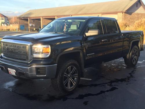

Nitto grappler g2 295/60/r20 on 2.5 RC level with only front installed. Very minimal rub at full lock. Rub on back of wheel well carpet. Love them, very quiet!

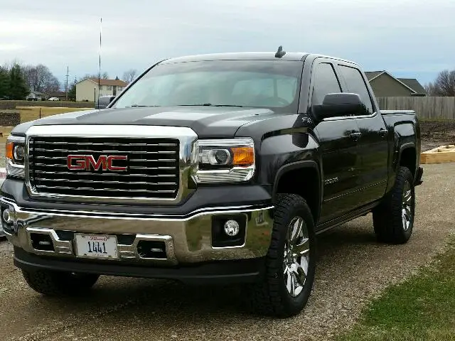

UPDATE:
here they are 305 55R 20s and They look awesome, fit great ride nice. Rough country 2.5 level kit with rear blocks.

UPDATE:
Looks awesome dude, but please but a few more pics up (side views etc)

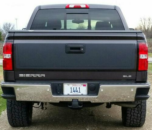

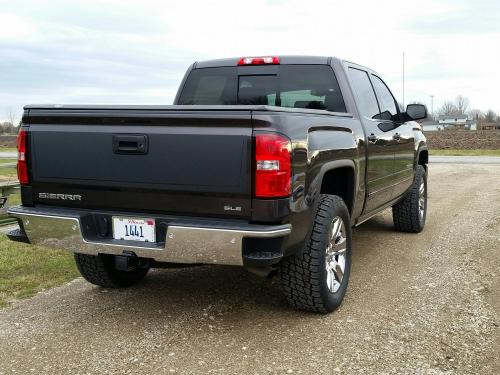

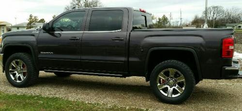

Super nice ! Thats look im going for, tnks for putting up more pics...helps out a lot
