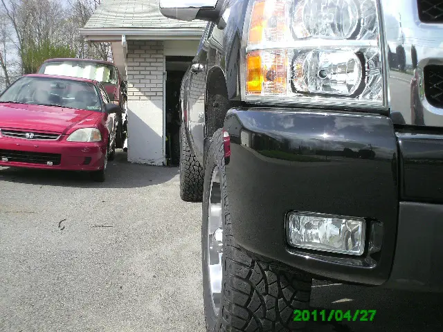

Of course if I go full lock and hold it there I have a slightest of rub on my sway bar. Almost every truck has that with 295 or 305's on a leveled GM truck. It's not going to hurt anything if there is a small rub. It's rubber hitting solid steel....not gonna do any damage bro.
When most people ask if a certain tire size fits they are concerned about trimming the wheel wells. Most people just live with the slight sway bar rub.
Here is what full lock sway bar rub lools like after 2.5 years
