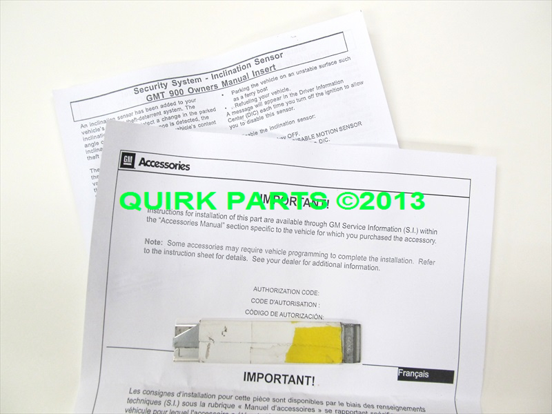

I recently completed installation of GM heated seat kit (19159306) on my 2011 Suburban. I took the truck to the dealer to have the system activated and they have indicated that I need an "authorization code" that should have been included in the box. My kit appeared complete. I have read that some dealerships can get the heated seats to work without issue, while others struggle. Is there really an authorization code needed? I know that adding tilt sensors and remote start kits require these codes, but should my seat heater kit have included a code?
If there is a program to load for them to work then there is a code necessary. The code is usually on the first page of the instructions.
Looking at instructions now. 24 pages. Eight English, eight Spanish, eight French. No code. Several service procedures (how to remove seat, how to remove seat cover, etc.) but no authorization code.

When dealer installed the 2 way remote start on my truck, they told me they had to call tech line to get the code and then activate it on my truck. They had to call a couple of times, and had issues getting the truck to accept the code. I got the entire kit back from the dealer (I had asked them to leave everything left over, or parts taken off in the truck) and there is nothing like an activation code. The instructions gloss over the call to tech line completely. They simply say to call tech line to activate package.
I was told by the parts department that only a dealer could install this kit and get it activated due to having to call tech line for a code. Looking at the kit I got, it was obvious that essentially all of the electrical parts you would expect to get in a remote start kit were already part of the truck. Kit contained a hood ajar/open sensor, remote, antenna and instructions. There is no way to get the GMAccessories remote start kit to work without calling tech line.
