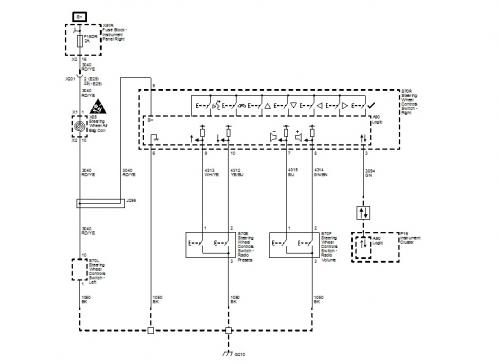

I have the same truck, I use my tablet as my head unit, connected via Bluetooth to the truck. Then I order this Satechi® Bluetooth Button Series (Media Button) for iPhone 6 Plus/6... http://www.amazon.com/dp/B00RM75NL0/ref=cm_sw_r_udp_awd_vpHxvb126JYDC and connect it to the tablet. 3m tape to the spot on the steering wheel where the controls should be and done, steering wheel controls.
steering control schematic
Thanks for the schematic Ravageur1972.
I've been trying to figure out how to add audio controls to my 2014 WT. Do you have a WT? Were you able to add them?
Thanks,
James
Thanks,
James
yes my truck is a WT but yes if i want i can add it , with some work to do
.you will need a new steering with all control on it . or buy every buttons. module , trims , etc etc to rebuild your steering
then you need to know if you have every harness from clock spring to block fuse and instrument cluster (for communication between modules)
then you need to know someone to reprogram every modules that need to be reprogram.
you may also need a new instrument cluster but not sure for this one. (need to check)
installation isn't hard
i saw some steering on ebay for 200$ about
