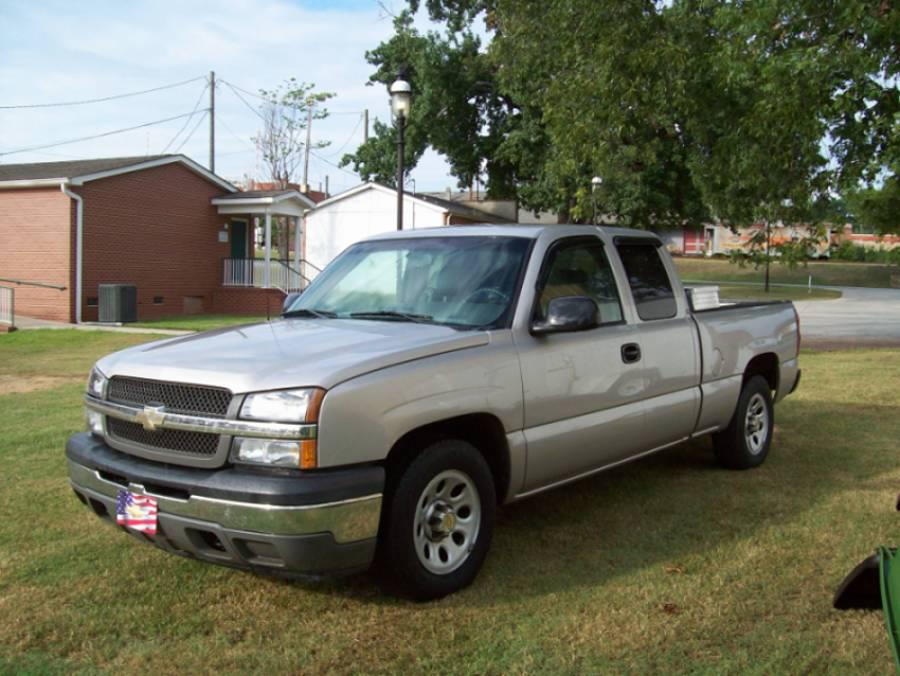

Hello, I have an awesome 05 silverado 1500 (not a Z71) with 17's 6 lug, ext. cab and 5.3L, I'm about to replace the front rotors and pads and my search shows rotors for trucks with rear rotors only and trucks for rear drums only. I have rear drums. Whats the difference in the front rotors with rear drums vs. rear rotors? Thanks.
