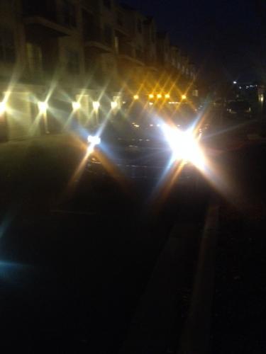

Xenon's installed in headlights in Chev 2500HD
I went the Xenon's instead of HID's. No drilling, just straight plugnplay
I have used the XD5's 5800k from Ebay before. They are brighter than OEM bulbs and less than 1/2 the cost of Silverstars. Noticeable improvement. Only $ 28 both sets shipped to my door. The H11 are 55W, and the 9005 are 65 W.
Installation is a bi#ch. The covers on the back of the headlight assys are twist and turn- There is a small tab on the bottom. clip this off and they go back in much better. You need to pull the air box on the pass side.

Do you have any pictures of your truck with the lights shining on a garage by chance? Would you still recommend these?
  • 4 weeks later...
Hey guys- I will try and take a picture of lights shining.
The GMC uses the 9012 dual filament( I think) and you may have to use the Silverstars.
The reason I like the XD5 on ebay is they have vey little blue tinting and seem to be the brightest ALso they are 9 bux a set. I have the 55w H11 for lows and 65w 9005 for Highs for my Chevy.
