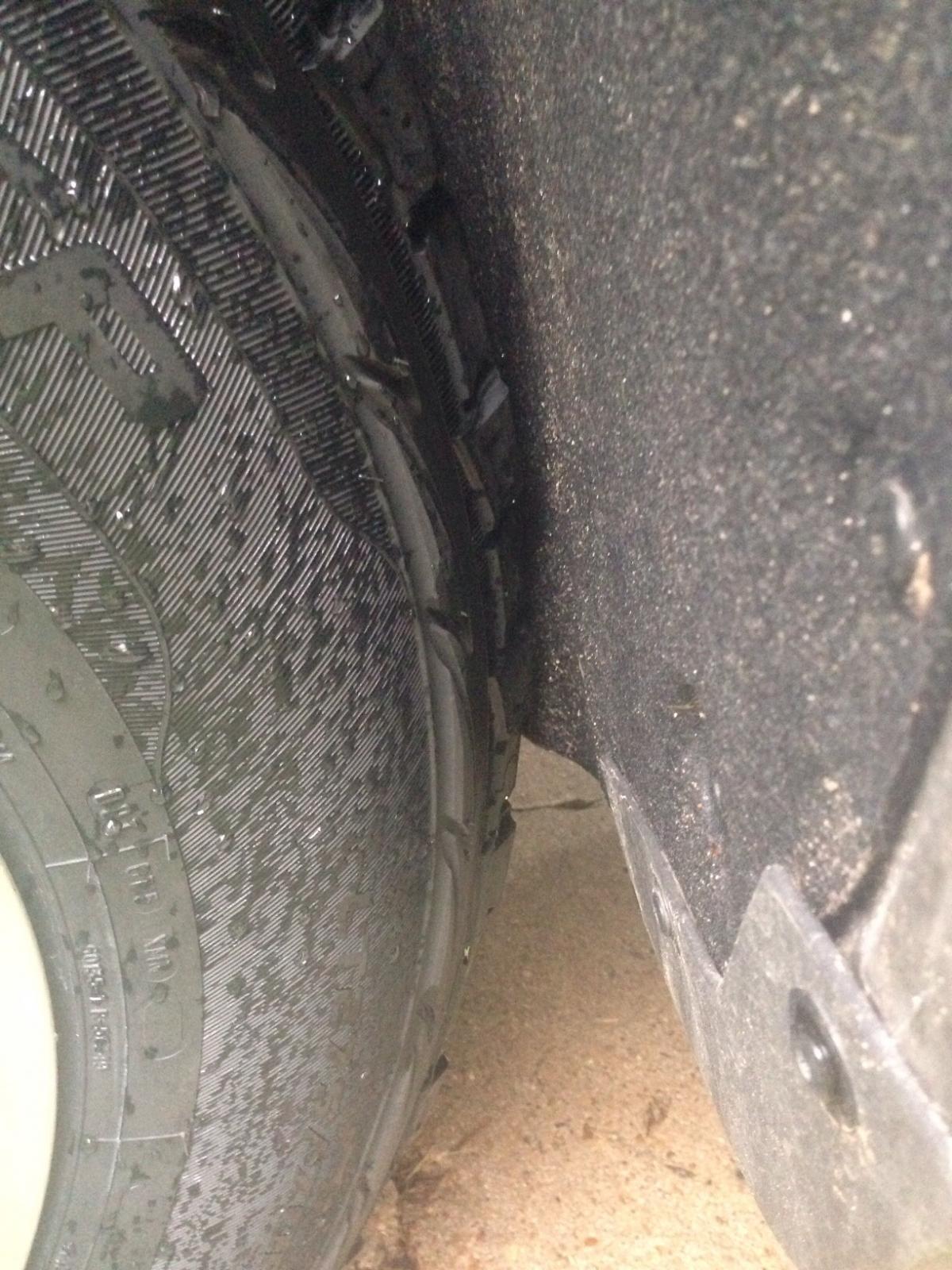

Appreciate the replies guys. Just wanted to report that I just had 275/70/18's installed on my '14 Silverado 1500 LTZ Z71 today and I will be needing a 2" leveling kit as the Cooper's ATP have minimal rubbing.
I'm still happy with the size and the little extra ground clearance is welcomed.
Thanks again guys!

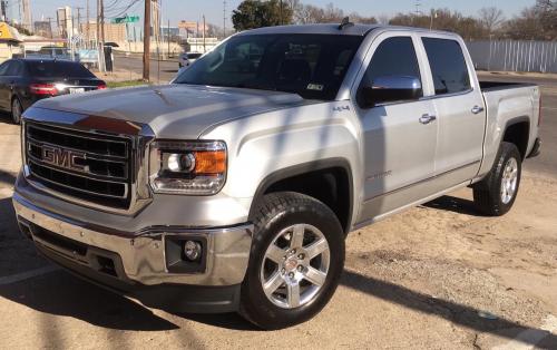

2" r.c. level with 275 70 18 bfgt all terrains. no rubbing and I did not have to trim anything.
I really like your truck. I've been trying to figure out what to do to mine that I just bought. Thinking I'm going to do the same setup as you. Do you still like this setup or have you changed it up?
no I have not changed anything since that picture (except taking the chrome side moldings off and put an A/T grille on it). It rides great and looks "right" in my opinion. I only plan on adding a few more things in the next few months hopefully and that is some black 18" wheels, 15 tow mirrors and some bags in the bag for towing. i have towed a couple of vehicles with the level and it was not sagging that bad but if i was driving at night it would have been blinding other drivers esp now that i have HID's.
kinda went on a rant, moral of the story is as far as the suspension goes nothing is changing and I love this setup / truck!
