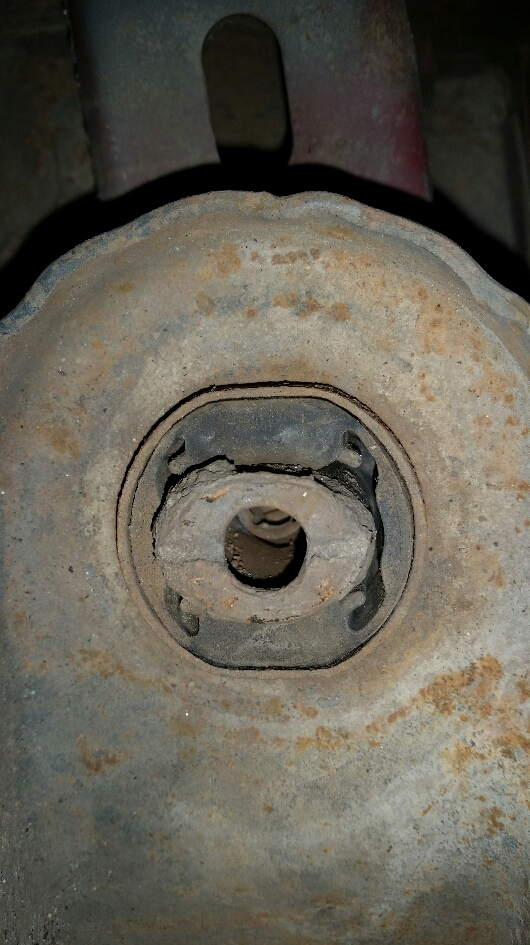

I have a 05 Silverado and my neighbor has a 04. I took my side steps off and went to put them on the 04 but There are no bolt heads. And the lower mounts look different than mine. It's like a special tool might be needed? I have never seen anything like this before. Any ideas?post-138686-0-27428400-1421727261_thumb.jpgpost-138686-0-04125100-1421727275_thumb.jpg
Are these pics of yours or his? Honestly if those are his and they look like that you need to find his bolts and washers cause his are MIA.
Those are his. All 6 cab mounts look like that. I just took out one of mine and tah dah! His truck is missing all cab bolts and lower bushings. Truck is parked until we get some in.

WOW! ALL of his cab bolts are missing. That's unreal.
Yep. All I can figure is someone pulled some steps before selling and kept the hardware.
As far as being broken, I can't see any bolt up in the holes so IDK, but we will find out!
I was just thinking tonight just to be on the safe side you might want to check the bed bolts and rad support bolt also.
Only the 6 cab mounts were missing. We ordered lower bushings "cushions" and picked up some bolts. There were no broken bolts inside just missing hardware. Nothing else was unusual with the other mounts. I firmly believe when this truck was traded in, some steps were removed and the hardware taken. How rude! And dangerous!
