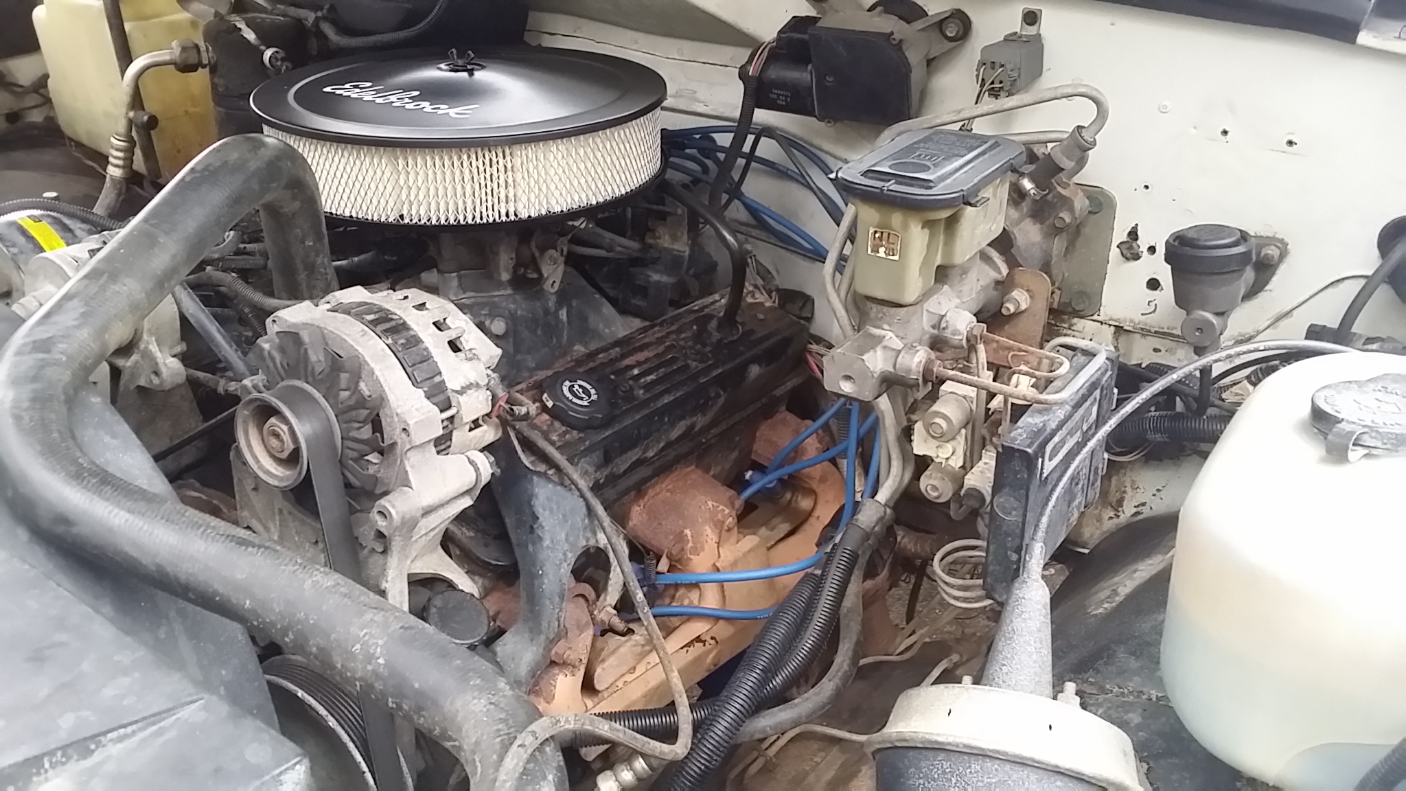

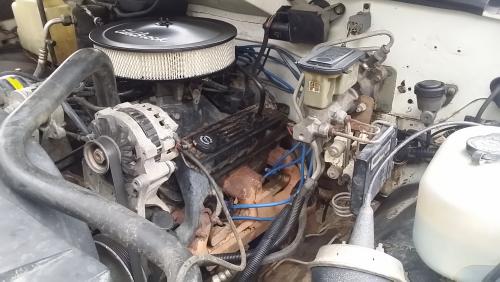

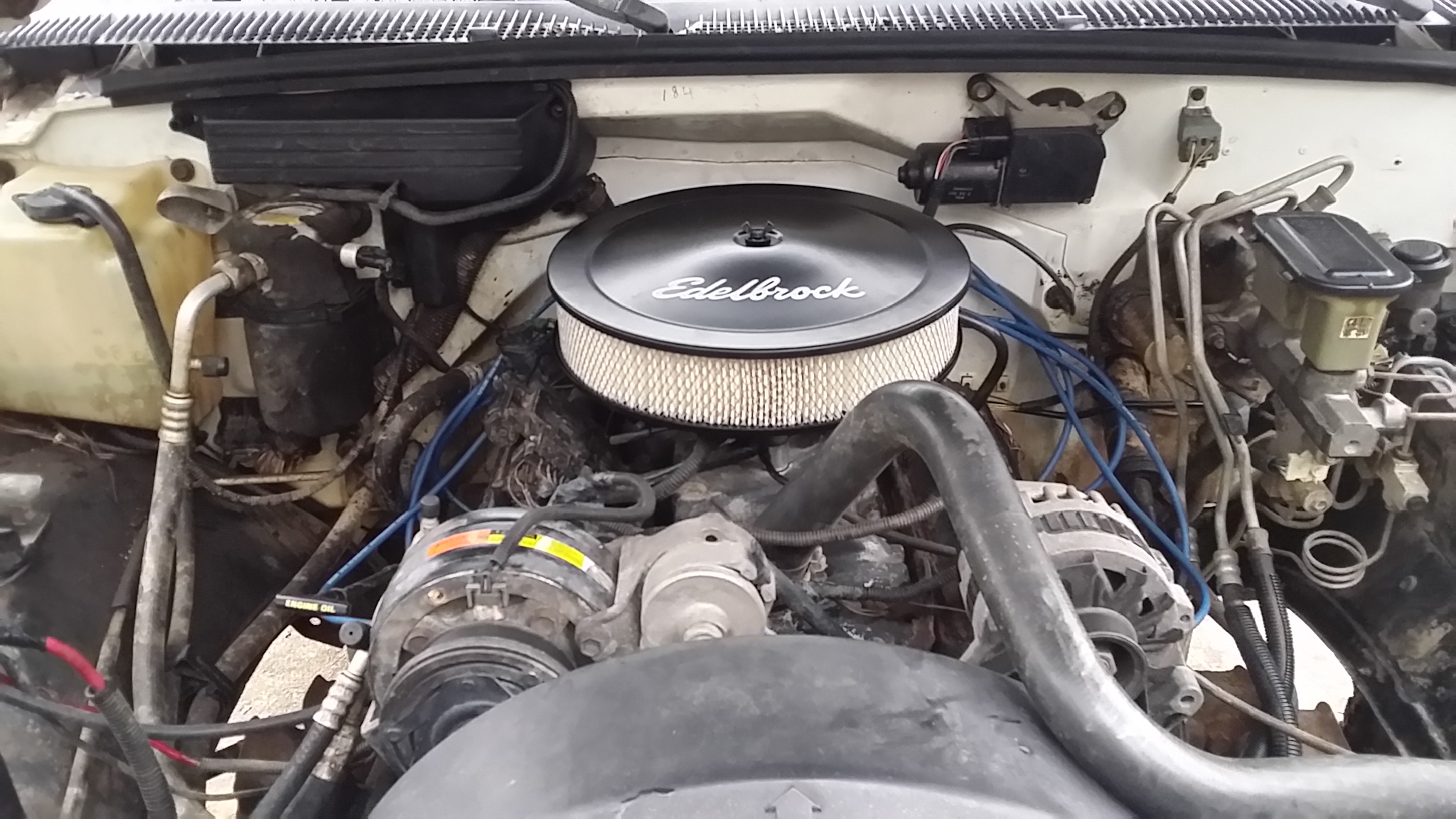

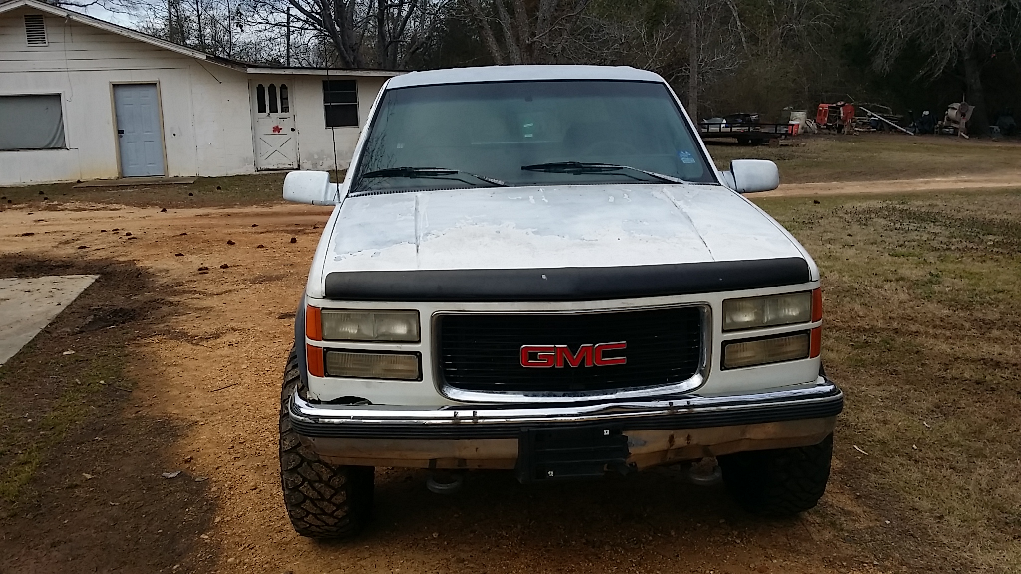

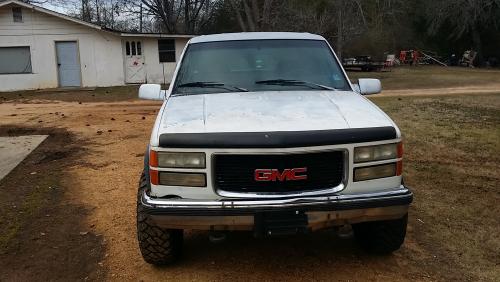

So some of you may have seen my other threads but here is a dedicated one. I recently purchased a 1994 GMC K3500 crew cab w/ 5.7L 5 speed. It has alot of minor issues and a few major. Got it dirt cheap though and I enjoy tinkering with trucks anyways. So far on things I've done is as follows:
Replaced transfer case.
Removed a ton of random wiring.
New tires- kenda klever 285/75/16s.
Rewired PO'S garbage speaker/radio install. Complete hack job.
Fixed issue with ignition. Truck would start but wouldn't shut off. Also it would stick in run. Replaced the lock cylinder and found that the teeth where worn on the end of the ignition selector rod. Pulled it out and tack a piece of metal on the back to keep it from popping up. All works fine now.

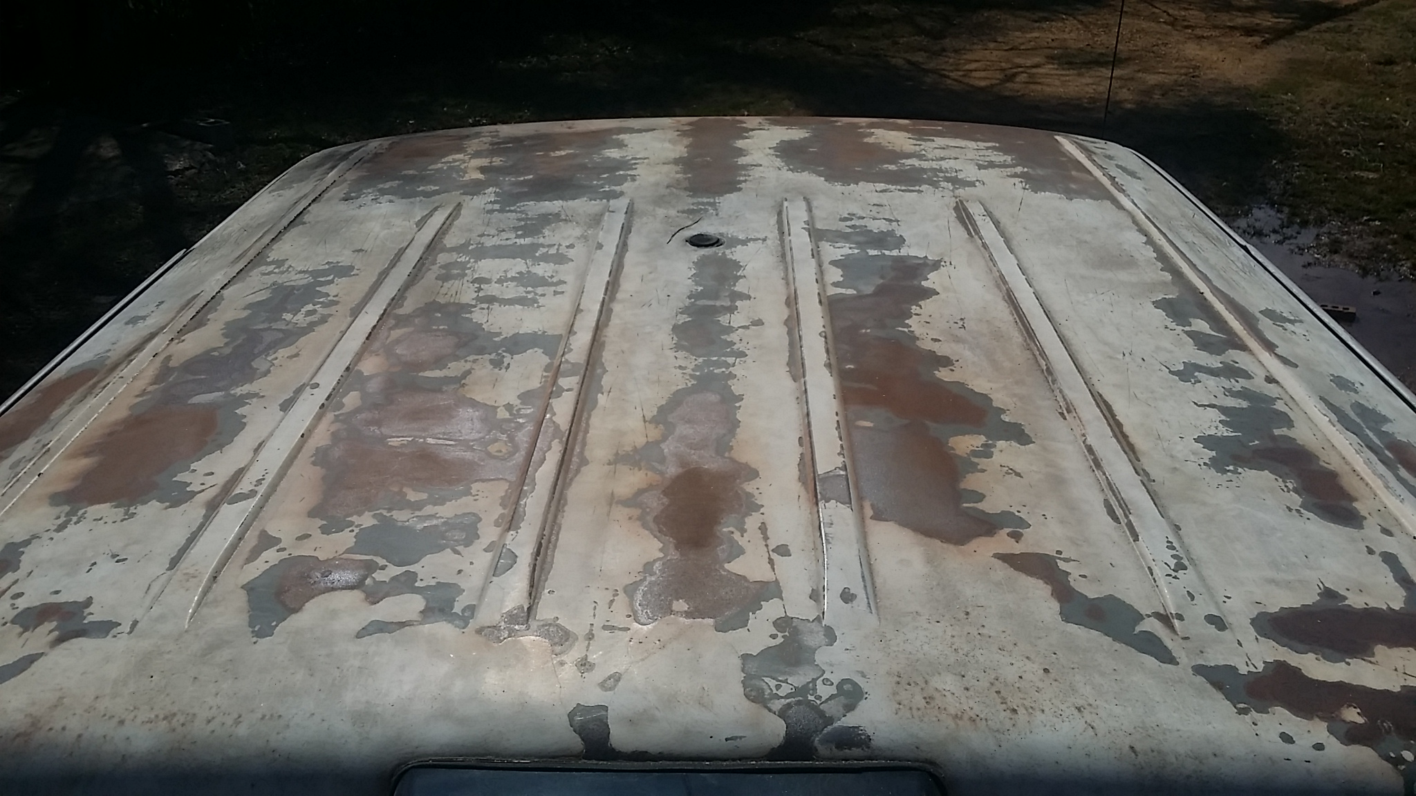

Cleaned interior and exterior. I have a good idea now of all the exterior prep work needed to paint. Need a front clip, front and rear bumpers, tailgate and possibly a new bed. I've already got the paint and primer. Waiting for better temps.
Changed the oil, flushed the brakes and power steering.
Still have to do a tune up. with time.
Here is some pics so far:
26281069efaa81330014c0bd3e8ca6b2.jpg4b9090a1628302afb3e249f411a3d9f6.jpg481b770fa6f2f983f01218a0817361bb.jpg70404b477fb9774571ddaf779f7b1eaa.jpg9d1f8e9a1ec5dd01fdafcd732e824c5a.jpg18f5fabac085e6cf89bb6cc2a75d34da.jpg598d1b0760347202bd0d80ab88ee3737.jpge3a2cba122376dea79a263876b06d2d7.jpg don't mind all the tools. For work 9b74e6ebc8909b9ff9c55a83aa2f138c.jpg91b6015c5ca086daffca2ed1053b9f1e.jpgd7e9370825040bd3de2cf4d483686a3d.jpg

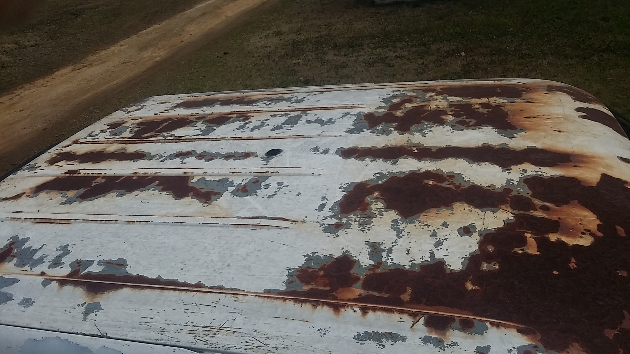

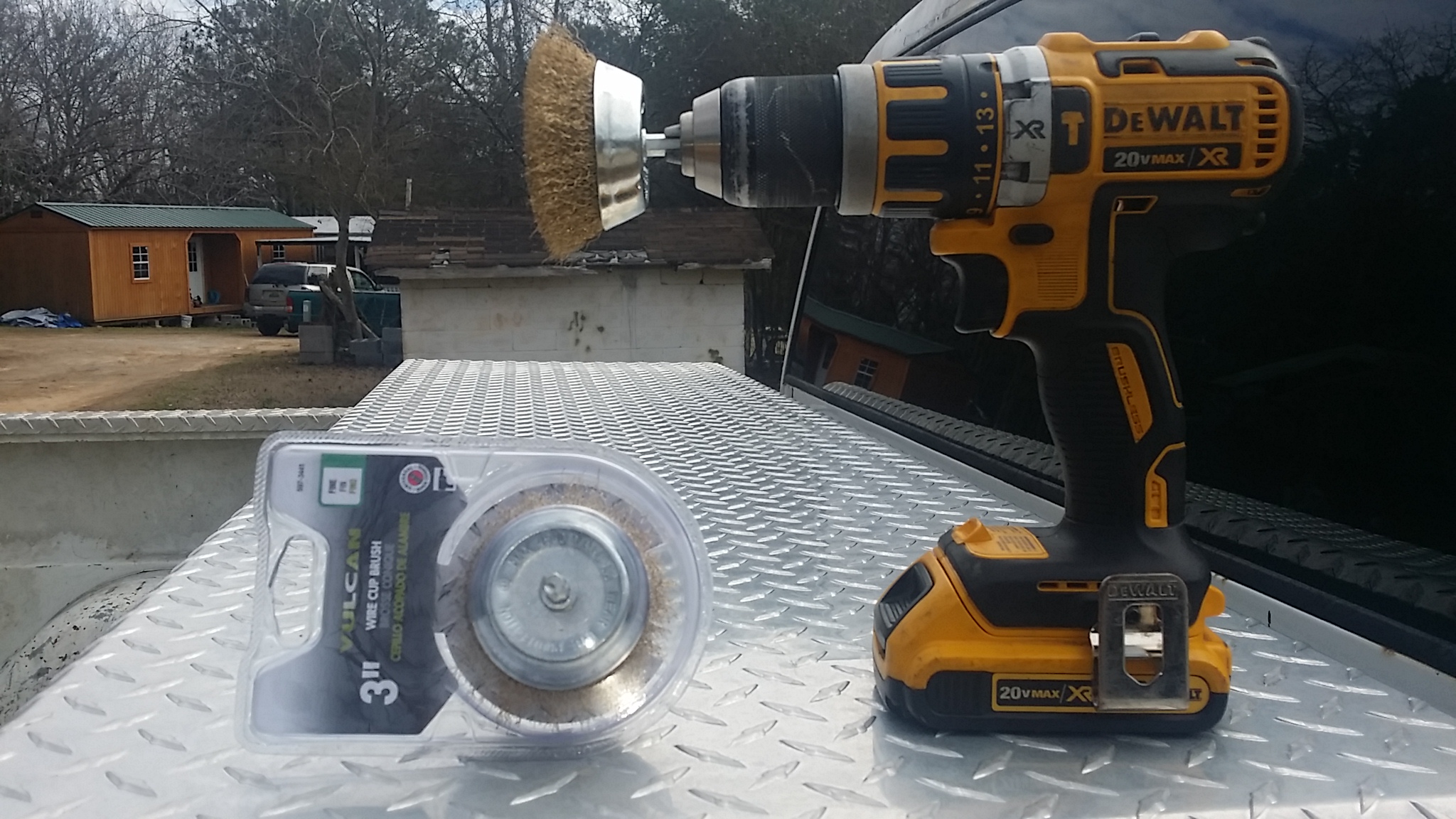

So a little work this weekend. Replaced the front sway bar end links. One was broke and the other was missing all the bushings. Also temporarily dealt with the rust on the roof. Was pretty bad. I just hit it with a wire wheel and some 120 and 400 grit sand paper. Hit the rust spots with some rust inhibitor and then some primer. I'll knock it down to bare metal when I paint it. post-138915-142523431257_thumb.jpg

It's a work in progress for sure. Guess I'm gonna look into photo bucket for pics. It's a pita having to post one pic at a time
