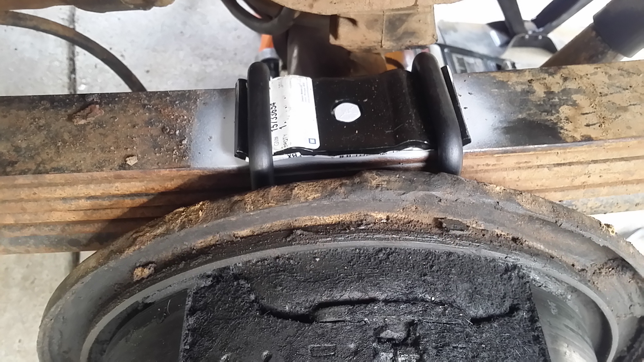

Well some work today. Been having a brake issue. Leaking rear hub seal. Figured I'd paint the drums and clean it up a little. 74053c23c198e5f3ecdea98796c90204.jpg
Also replaced both sides u bolts and top/lower plates. Odd to have very rusted parts here Alabama.

Well I replaced the hub seal today. Pretty simple job. Got the drums cleaned out and adjusted in. Also got the parking brake working properly on both sides. Where the passanger side ebrake cable runs into the equalizer bracket was loose. Will take it for a drive tomorrow and retighten the new ubolts. 16762ce62a0c808bf2230e145879d544.jpg1c7111a4a519787f1207c07194fbd85b.jpgbe11d25ccdafa8f371375de84a3d1f1b.jpga67fa8df50ec0f5f0b03122e963ebe28.jpg

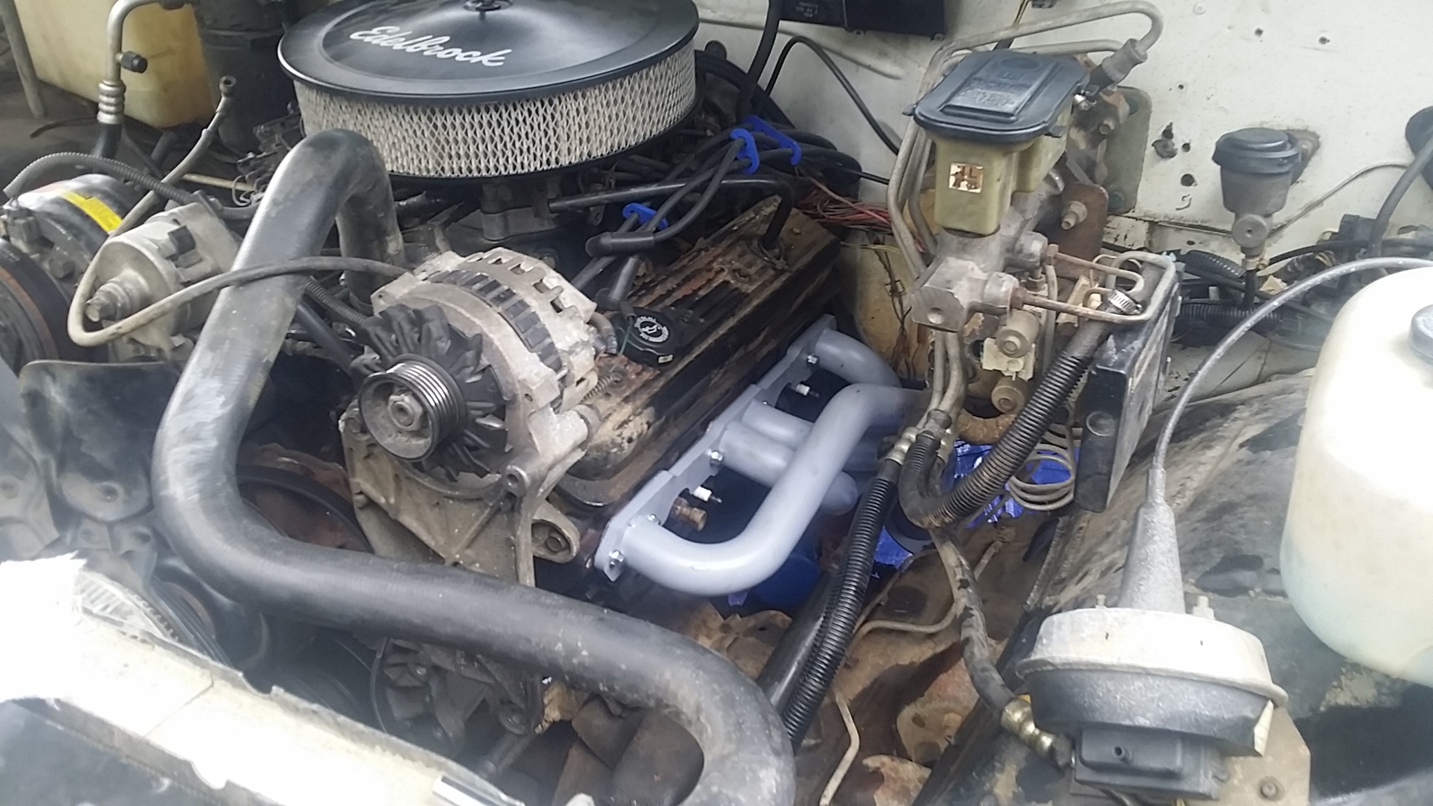

Thanks. It'll be there one day. Next I'm doing some shorty headers to replace the cracked manifolds and install an 02 sensor. Going from the old 2 wire to the heated 3 wire

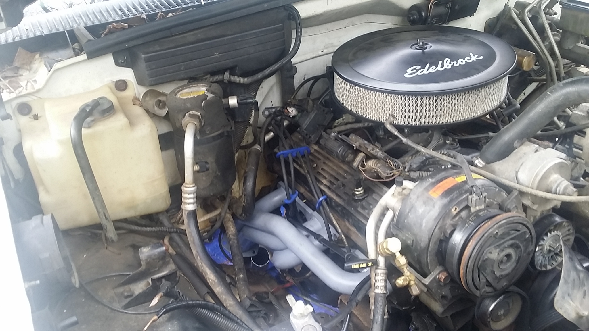

Ok. It's been a while. So I've done some work and tinkering. Got my headers baked and installed, what a pain. Wired in a 3 wire O2 sensor as well. Reset my ECU and walla no more check engine light. Still have lots to do with paint and body but it's starting to come together.
