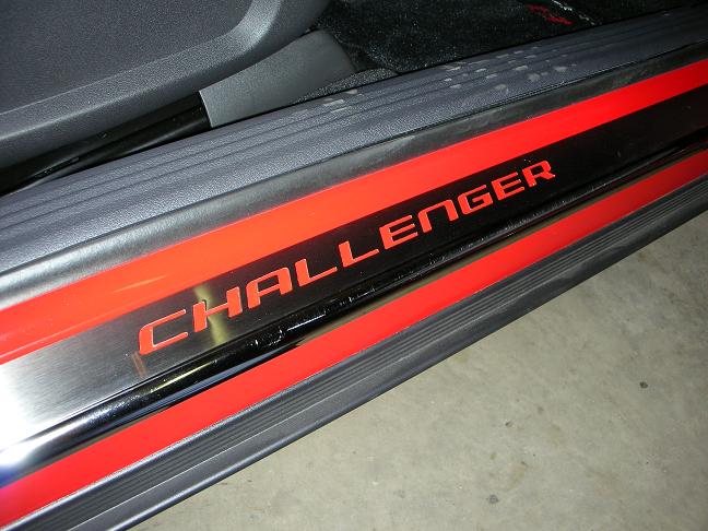

I have done this often by spraying the paint into a container. Let it set and keep stirring it until it becomes the proper consistency to brush on. If you use a headset magnifier while filling in the letters, your vision and hence your painting precision will be better than anyone who looks at later with the naked eye. Assuming you have steady hands that is. Not a manifold or GM but it shows the results.
