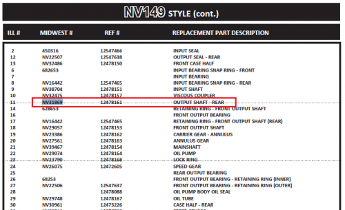

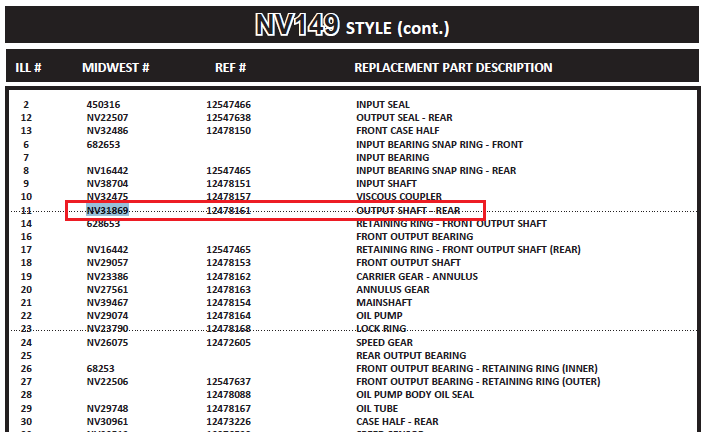

I have a site that lists 3 ," front output"," rear output" and "all applications" which the number you provided is for ,
I need to know which one you need , as the pic posted didn't work ,

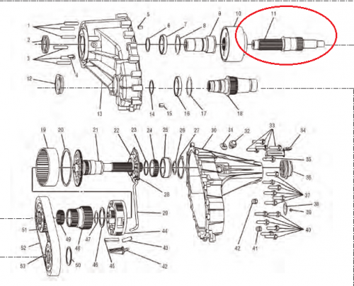

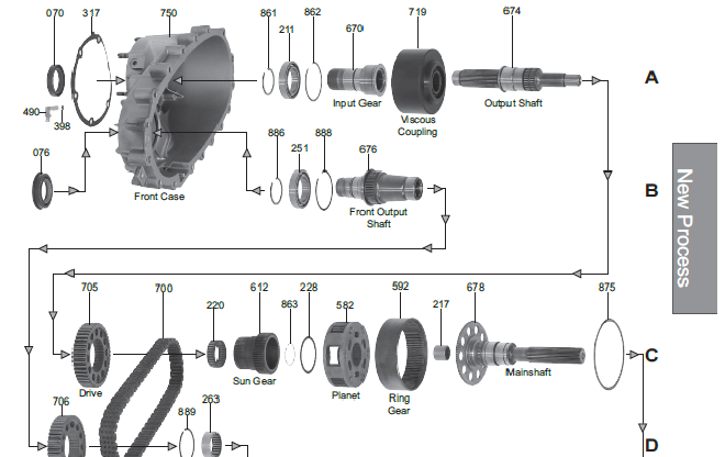

I have to find a blow up as the parts are refered to an item number
I couldn't find a diagram at that site

that the question i can't figure out, some sites shows that is outshaft, and others says is main shaft
Which one is the p/n you provided?, I saw the pic , you have the right part number because it's is the only part that works in " all applications" , the others are dependant on output component , driveshaft yoke is the component ,

It's an online service manual I used , that shaft is common to all t cases no matter what it's in , you have the correct part number .
I thought that was the common shaft but it's not , go with that 8161 shaft then , it just called it a rear output shaft ,
