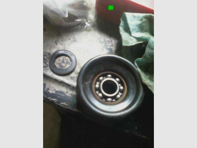

On the subject of bearings and pulleys ... if you could see how LITTLE grease is put in bearings these days, you'd be shocked. It's a wonder they even make it to 10k miles! On my own stuff, I normally carefully pry out the little seals on the bearings, and grease them up with my own stuff, even when new. I get much more life out of them that way than normal.
This one here was squawking like hell. A little grease and she was happy. I was a little rough on getting this seal out, but it still worked after I flattened it out.
