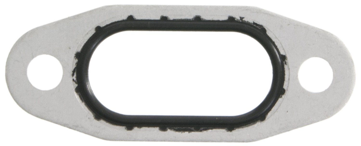

That looks like the blockoff plate gasket. Do you have oil cooler lines that originate from this area?
If you do, make sure you get the gasket for trucks with the external oil cooler. If you don't, get the blockoff plate gasket.
Note: Both gaskets may be the same part. I haven't compared the two in a while. The gasket I used looked identical to the picture you posted; I have a blockoff plate setup.
