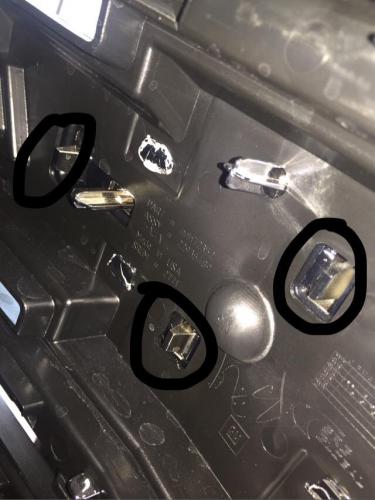

I just bought the front and rear black replacement bow tie logos for the gold ones from GM for my 2014 Silverado. The part number is 23463799. I know that the front logo is clipped in. Is there anyone out there that can help me with how to pop the front logo out and get the new one in without doing any damage to the clips? I have attached a photo of a picture that I found of what the front looks like with the clips behind the logo. Thank you.
Use a set of needle nose pliers, if you want to be extra safe put tape or something a little soft on the tips. Don't go HAM on it just put a light enough pressure to bend the clip in and move it out enough to go to the next one without it popping back out. It's easy, just be patient with it or you will snap them.
If you need to bend them back out just take some fishing line and lightly pull from behind it, worked great for me.
You can do this with the grill on. I found a post on here the other day, followed it, and had my new bowtie on within 15 mins. I'll see if I can find it again.
