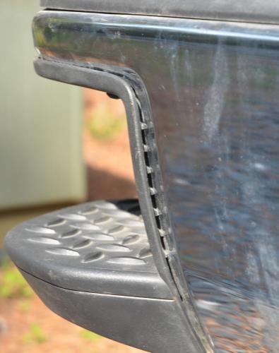

I recently had a defective bumper replaced free of charge and just noticed something isn't right with the trim around the drivers side corner step, rear bumper.
Please take a look at this picture and let me know if I should return it for repair, or is it something I can do. I removed 3 star screws and one small hex nut but that doesn't free it up.
Thanks!
Looks like it wasn't pushed in right. All of those little knobs look like they just need to be on the inside of the bumper. You can see some of them bent. Use a screwdriver or something and push all of them in so they're on that edge of the metal.
Thanks for the reply. I don't understand the workmanship of today anymore. That's all plastic and if I break them I am liable. It will be cooler tomorrow and maybe I can make some headway. It can't be rocket science...LOL! Have a nice day!
