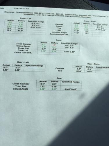

2010 Silverado Crew Cab Z71 4x4 Bilstein 1500 lift highest setting
Hello,
I installed the Bilstein 5100 height adjustable on the front of my truck and then had the truck aligned. Somebody was asking about the before and after front end settings for the alignment. Here is a photo of the adjustment sheet after an alignment at local Chevy dealer.
