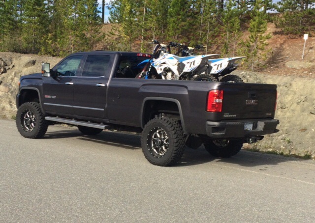

The 275/65/20's are the best fitting tire as they are not to wide or tall for the stock wheels, if you go aftermarket (wide) wheels or lifted that changes everything, it is so nice to spend a day (not cutting the sub frame with a torch!) Installing a proper leveling kit that will not need touched for 150,000 miles and a tall set of tires and just driving but I know some want the whole lift wheels and tires but that is a lot of work and money.
The Rancho kit is great, as long as you're okay with it being a 5"+ lift. If you want to run 35's you will need it, depending on wheel offset. Withi've got 35x12.5 Toyo MT's on 0 offset 20x9 BMF REPR's. I still get a tiny bit of rubbing on the front bumper, it's not bad enough to make me shim the bumper forward though.
The ride quality is awesome, truly as good or better than stock. The truck rode like a tank when I had it levelled.
The NTSB raises the torsion bars up so it's the nicest looking lift IMHO.. And it doesn't make the front track width wider than stock, either.
i bought it in July. Not sure what deals are out there now but when I bought it, the kit could be bought for $1960 online without shocks. The RS9000X's were around $100 each, and there was a $500 mail-in rebate.
I was worried about quality issues but I'm very pleased.. Much better results than I got with a much more expensive and highly touted 3" Carli system I had put on my 2012 Ram 3500.
