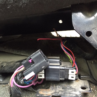

2. the service airbag light is on, I pulled the code and found a broken wire under the passenger seat. Does anyone know where the wires are supposed to connect to? is the plug in the picture supposed to be plugged into anything?

As for the wiring you should get the electrical schematic.
Your photo shows two wires disconnected. Find the place on the connector where there are missing wires. Then look at the opposite side and see if the wire there matches the color of the other wires.
thanks, I actuly fixed the airbag issue, i just connected the broken wires by matching the colors and the problem cleared.
