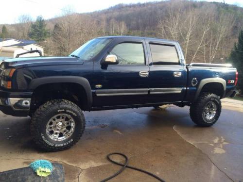

Hey ya'll. I am a proud new owner of a 2006 silverado crew cab. However I am having some weird issues crop up, just days after I have purchased the truck. Was wondering if any of ya'll have dealt with these issues. Heater/ AC Fan/Blower doesn't want to come on after it is turned off, unless I repeatedly turn it off and on. The radio has hardly any speaker sound left to it. First day I had it it was ok sound, but only passenger side worked properly. Now the front speakers are the only ones working but VERY quietly. The door open chime is barely audible from the driver side speaker. Also the airbag service message keeps being displayed. I dont want the bag to blow off on its own while going down the road. Can that happen? Dealers are outrageous expensive, and I just haven't had much luck with them actually making proper repairs. I am curious as to what approach I should take and where to start the diagnosis on these issues. Also have a check engine code of P0053. Had that read and it states HO2S heater resistance(bank 1, sensor 1)Two times it comes up in the scan. However the definition of the code from Autozone reads (bank 2, sensor 1)? Is there a main electric box issue, or many different issues? I dont know exactly where to start. Thanks a bunch!
