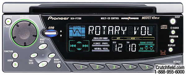

Hello,  I am new to this Fourm.   I have a few GM spcific Audio Questions.  I am looking to Upgrade the stock stereo :chevy: .  Here is a combo that I am thinking about:
Head unit: Pioneer Deh 77
Front Doors:
Boston Acoustics RC620's
Rear Pillars: Boston 746's
OR
Boston FX7's
Both Powered off of a 50 x 4 amp.
Later I intentd to add a sub box and Class D amp.
What do You think of this Combo?  Sound Good?  What would you change?
I am open to sugestions.
Thanks
Eric

I wish someone else had a 1.5 din head unit. The main reason for the Pioneer is the size. In other vehicals, I have lost many systems. Most of the time It was because they could see it wasn't factory.
I am looking for the best Factory looking sound.
