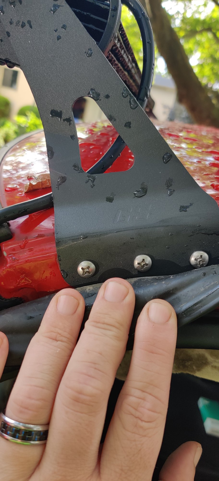

I have a 2002 Sierra and I installed a light bar with the mounts that go behind the weather stripping. Before install, I had zero issues with leaking. Now it leaks a little water and develops a puddle in my floor mat. I just removed the bracket and out the weather stripping back on and it still leaks. Is there anything i can do to make my truck stop leaking water? It's leaking right in front of the seat on the roof. If I have to take off the light bar to stop the leaking I'm fine with it I just don't want any water in my cab. Any help is appreciated!

Same here Im going to attempt to fix it today on my 07 Silverado its doing it on both sides for me so its definitely the bracket and not the power wire and for me its hitting my seats not so much my floor mat maybe we have different brackets or positioned them slightly different

I'm in the same boat someone finds a solution I'd love to know rough country brackets put on my 2003 gmc seirra leaks on both sides never leaked prior

I bought some weatherstripping from autozone and cut it in half put some onbotb side it helped I read it in another forum I think it was 25 bucks Ameriseal multipurpose weather strip 3/4”x7/8”x8’
