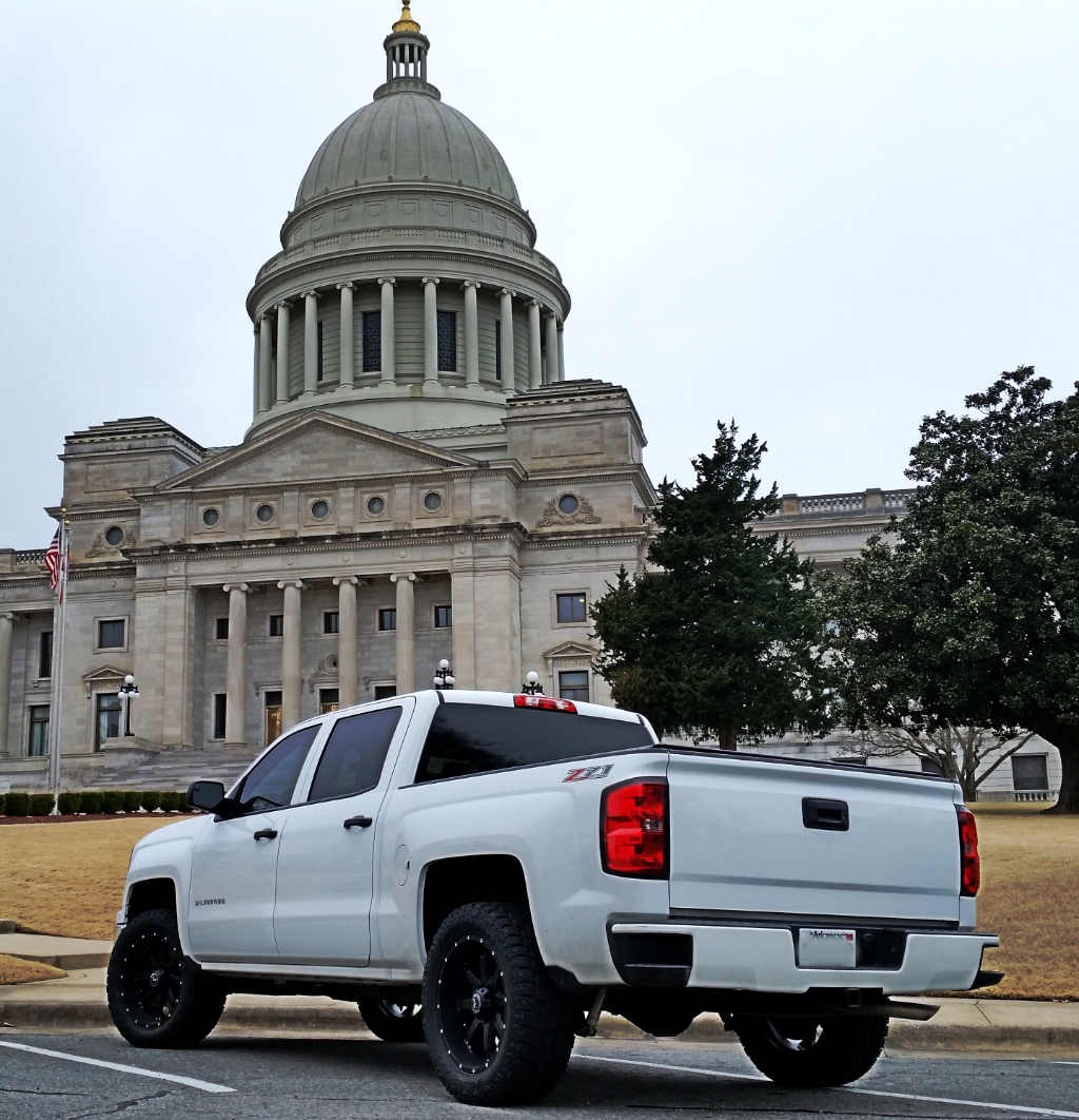

I have a 2.5 RC level with a +1 offset, which from the naked eye you cant tell the difference from a 0 offset. 305/50/20 tires no rubbing at all, plenty of clearance, when I do tires again I might try 295/55's but for a brand new truck I wanted to assure no rubbing and correct speedo so I went with the 305/50. the photo below shows that the tires stick out from the wheel wells just enough to be aggressive and look good, but it is not over the top like the -24 offset setups

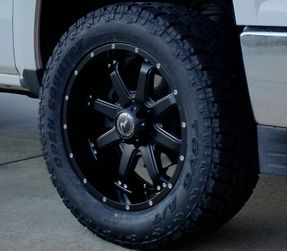

2" level , 0 offset, 33x11.50 tire, basically dead even with upper fender widest point.
Sorry to jack this thread but are these the raceline assault? I've been looking at them but couldn't tell how they would look do you have anymore pics
Awesome looks great!! Yea I don't see any around here it's all fuel I am digging the assault!
