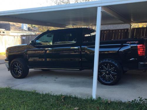

Know this was posted a while back, but I've been looking for someone with this exact setup! Looks awesome! Also the only other person I know that decided to just go for it with the 3.08 gears (mine is same). I'm not quite getting 18mpg though. Did you re-tune? About a month ago I did the exact same wheel/tire combo, but went with a 305/55r20 instead. I crossed my fingers and did the RC leveling kit, but I'm rubbing at full lock so I'm looking at the BDS 4". If there's no rubbing with your tires, I think I should be alright.
My only hesitation about installing the lift is not knowing the exact height it will take the roof of the truck to. Any chance you've taken a measurement? I drive through a parking garage every day, so just want to make sure I'll clear before I take the plunge. Thanks for sharing! Love the truck!
Here's a quick pic of mine when I brought it home:

I have a 4.5 inch lift with 305/55/20. My garage door is 80 inches tall. My truck has about 3 inches of clearance. I did cut a few inches off the antenna because it rubbed. I haven't had any clearance issues in any commercial parking garages either.
