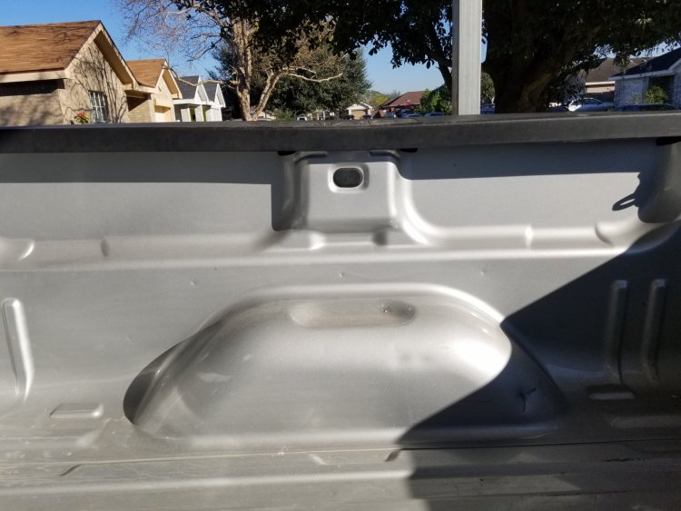

How to remove plastic bed rails.
this is what your bed rails look like without the caps.
Sent from my SM-G920R7 using Tapatalk
Holy S*#@t! What the hell were they thinking???
Actually, I guess they were thinking "...who would ever want to remove our beautiful plastic rail caps?"
My last rack was installed with small (1/4 or 5/16 dia.) nuts and bolts (two on each side) going through the inside vertical lip of the rack-rails and box. It was very secure and virtually unnoticeable when the rack was removed. This may be an option for you as from what I can tell from your picture your rack is constructed in the same manner as the one I had. I live close to www.expresscustom.ca/ and they did the manufacture and install. I was worried about them drilling holes until I saw how insignificantly it impacted my truck.

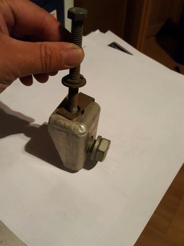

My rack was secured with a 'drill-less' system. Basically a three sided piece of 1/4" aluminum bracket with a captive nut fits in the stake holes and is secured with 1" bolt to the box through a pre-existing hole. A long bolt is inserted through a hole in the rack and screws into this bracket. See the picture:
This looks like a good and solid way to attach the rails. The picture sent by dkweeks certainly was a surprise! I had no idea the top of the box was so perforated! I don't know if you've bought your new rails yet but there is quite a demand for used headache rack and rail sets like yours. I was able to sell mine on http://www.used.ca/ for a good price. The short rails by themselves would be hard to sell. The amount I got for selling as a set would have made it cheaper for me to buy a completely new set than if I was to have new rails made and kept my old headache rack. Just an idea...
