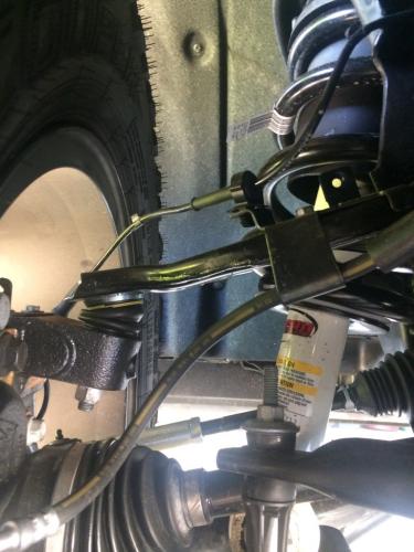

Angle on control arm after lift?
So I put a rough country 2.5" on my 2016 AT up front, nothing in the back. I also have 295/60/20 on stock wheels. I was looking at the angle of my control arms at the end and it seems pretty steep. I was wondering yalls opinion? Would new control arms fix this or what? What are the long term consequences of this?
Wow, that does seem steep for a leveling kit. Is that after an alignment?
New UCA will definitely help ya out, Camburg makes some nice beefy ones, Zone also has some nice ones a little cheaper than Camburg.
