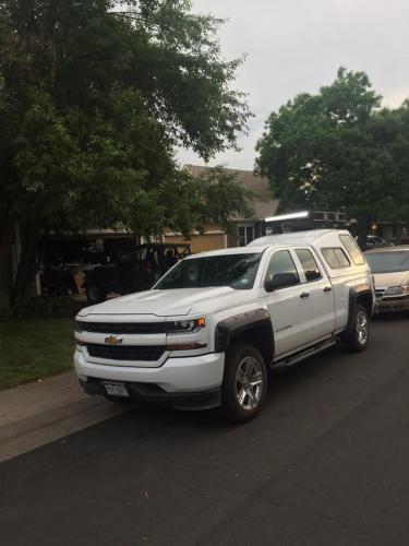

I have a 2016 Silverado with a Leer 122 camper shell. I added a LED light bar and wired it to the cargo light (with the shell this light is useless, but it was pre-wired and located in the perfect location. of course I didn't know that the cargo light will not work when the truck is in drive. I would LIKE to find a way to put power to the switch, and have seen some ways for older models, but I don't know if there is a way to do this for the 2016.
the idea is to not have to add more switches and wiring if I can avoid it.
