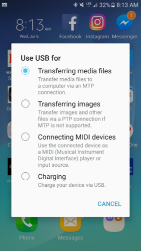

I'm writing to see if anyone else is having trouble using andriod auto or the projection feature on a 2016 gmc sierra crew cab , I have a galaxy s7 with android auto app installed and when I connect the phone with the Samsung oem charger cable I get nothing just a message pops up when I click on the projection button, I've tried opening andriod auto first and all different things but no luck , also on a different note my wireless charging doesn't work either , I bought the truck new and neither of these features have worked since taking delivery , any suggestions or should I just take it to the dealer for service??post-156706-146781310773_thumb.jpgpost-156706-146781311341_thumb.png

I have a Galaxy S7 on Verizon Wireless. I am on the PE1 which is the most recent update on S7. I have to use the USB port in the glove box to get it to work. The USB ports in the center console will not work other than to charge the phone. Also prior to the PE1 update, I had to manually change the phone from charging to MTP. After the update, it did it automatically after connecting the USB cable plugged into the glove box USB port.
One other thing I forgot to mention and maybe this will help. Under Developer Options in settings, I have USB debugging enabled. If it is not enabled, I have to manually change the USB Configuration from charging to MTP. That option is also in Developer Options under the Network section. If you need info on how to enable developer options, follow this:

Well you are correct. The console USB ports do work as well. I had a spare USB cable in console but it must have just been a charging cable. I swapped it out with the known working USB cable and voila, the console USB ports did launch Android Auto.
