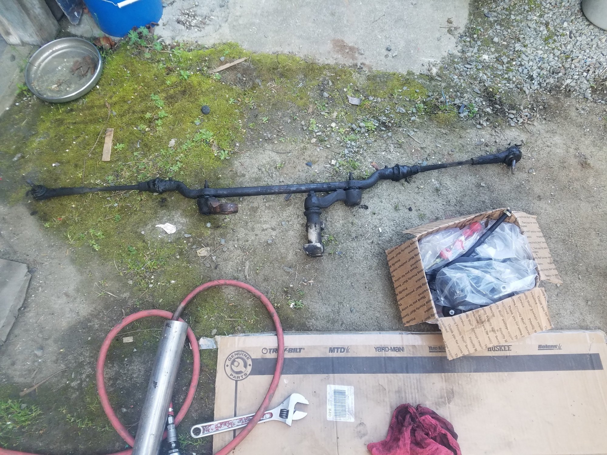

After bending a pickle fork and running to the parts store to buy another one, I got both of them to "pop".
I got off work early today so I'm back at it.
I assembled the idler arm bracket and arm outside of the truck and am about to put it back in.
Pitman arm has been under tension with a puller and a bunch of PB Blaster since last night.
Gonna loosen, then re tighten to see if it lets go.
If not, I'm breaking out the cutoff wheel.
Ain't nobody got time for that.77a73c411e9c251eb6965fdd79a3ef4f.jpgc093fb8f44358ba9d58caebc15f11800.jpg

And no, the whole assembly is still attached, sorta.
Steering box is loosened. Idler arm bracket is unbolted.
But I had already replaced the inner and outer tie rods before I realized how much of a PITA this was gonna be.
Sent from my moto g(6) using Tapatalk
