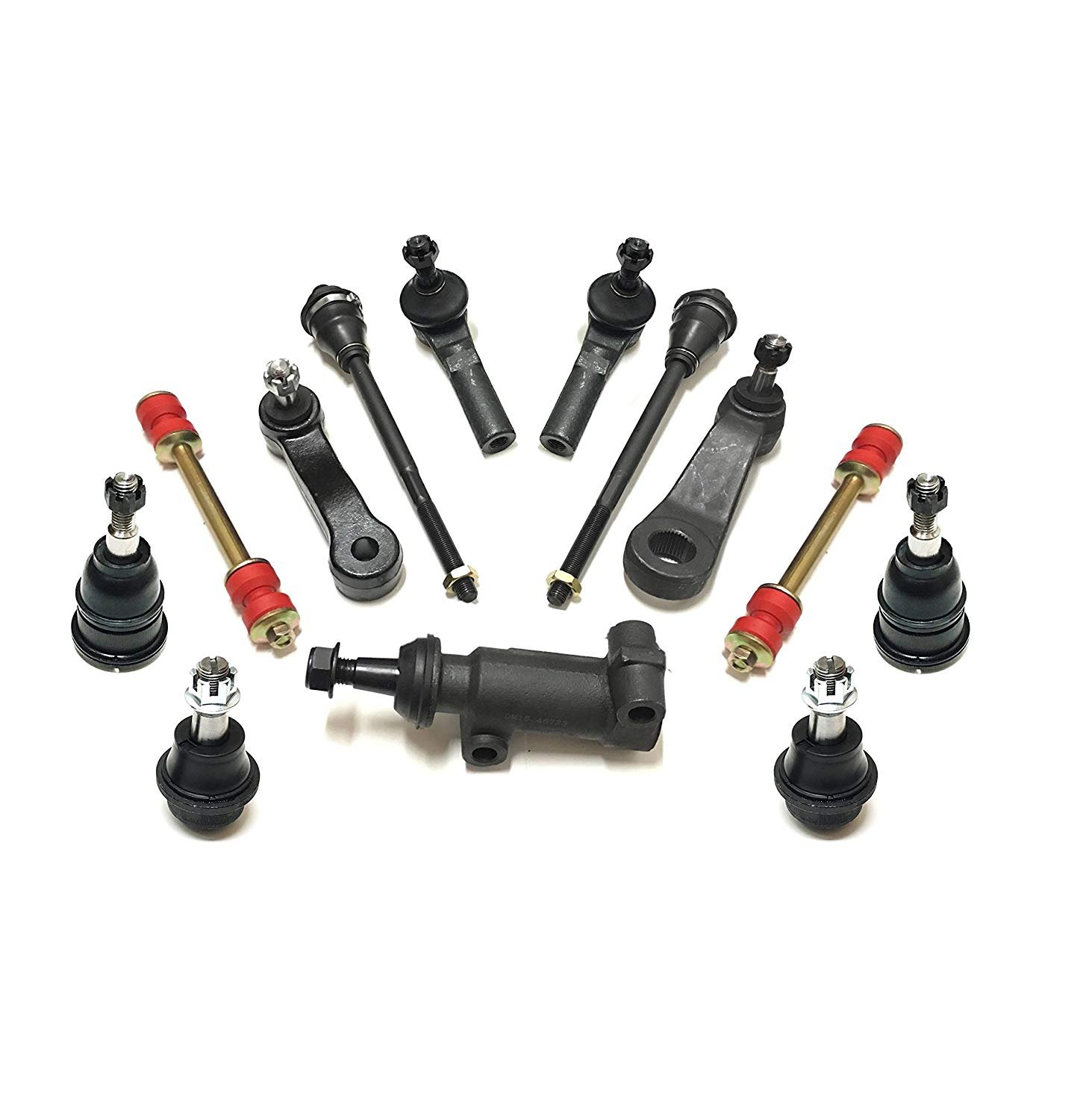

I installed both of these kits a few months ago. One was on an S-10, the other a 'Burban.
   Not very much fun at all.

All I have left are the Pittman and idler arms.
Have spent all afternoon trying to get them free from the drag link.
Heat. Pickle fork. Puller. BFH. PB.
Rinse. Repeat.
Pittman arm has pulled away from the steering box, is about 1/2" down the splines.
But neither of the "ball joint" ends of the arms want to budge.
I'm spent.
On a good note, my front sway bar got a fresh coat of gloss black paint. LOL
Sent from my KFDOWI using Tapatalk
Your trying to get the Idler and Pitman arms off of the drag link yes?
I assume the entire assembly is out of the vehicle.
I would just thread the nut onto the "ball joint" until its flush with the end, and then give it one good solid whack with a mini sledge. It should pop right out.
