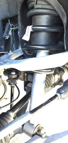

When you get a picture of the truck could you also snap one of the strut? thanks. I might get the struts from skyjacker one of these days.

post-162566-0-84617800-1474911853_thumb. here is a picture of the Skyjacker strut that came with the 4'' lift.
