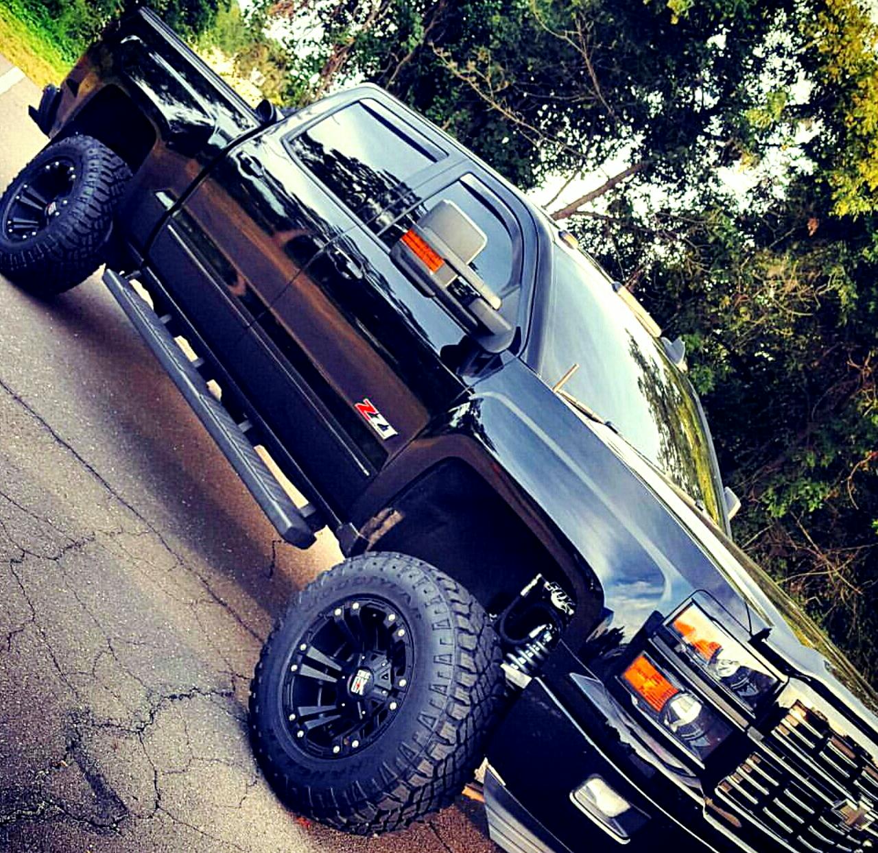

Just had a BDS 6 inch lift with Fox front and back installed on my 2015 Silverado Midnight Edition 1500. I have 18 inch XD 822 (-24 offset, 10 inch wide) with 295/65/18 Goodyear Duratracs. They fit perfect. I only had to trim the corners of the plastic piece below the front bumper. I got the tires for cheap so im going to keep them for my stock set of wheels. Im trying to see if anyone has the same set up or similar except with 325/65/18. (Going to stay with Duratracs) I talked to BDS and they said there will probably be extensive trimming involved but ive seen similar set ups and they said they didnt have to do any trimming. If anyone has the same or similar set up please let me know if you had to do any trimming, rubbing, or anything else. Thanks
