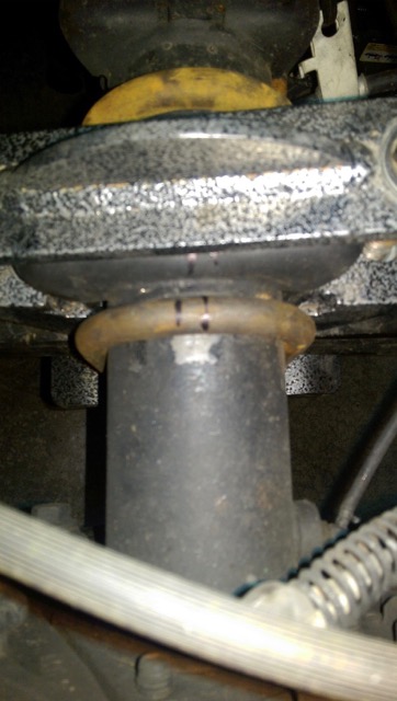

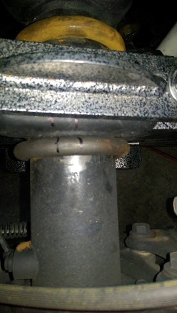

Its hard to tell every truck is different on whether any shims are needed with the McG or BT flip kits., I didn't like the DJM kit. It's a PITA to adjust and moved.
Here is pictures when the axle moved, that DJM couldn't explain.
