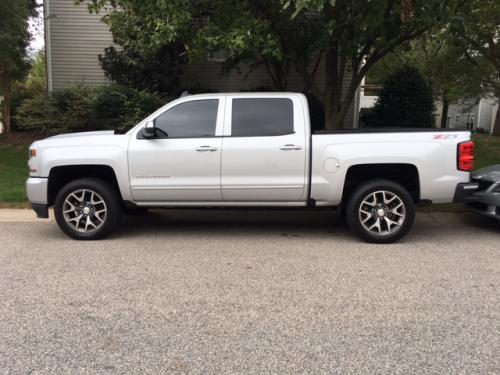

Hey Guys - new to this, Need some opinions here!
I have a 2016 z71 1500. I currently have a 1.25 inch front top spacer, but it does not sit as level as i would like.....
I have 3 options that I am looking into to accomplish the height I want to fit 33x12.5r20 (which will not be achieved using Bilsteins alone) while ultimately increasing my ride quality all around
Options:
1) Bilstein 5100 in addition to my front 1.25 spacer set at the .75" setting, giving me 2" total front and gaining nothing rear but switching the Ranchos to Bilstein
2) Bilstein 5100 in addition to my front 1.25 spacer set on the 1.25" setting and replacing the rear 1.25" block with a 2" block giving me essentially 2.5 in the front and .75 (from stock) in the rear swtiching the Ranchos to Bilstein
3) take out spacer and set bilsteins to the highest setting which is i think 1.8" (dont think that will get me fully level though, and ride quality may suck on that highest extension setting)
Questions:
1) Is doing 5100 adjustables in conjunction with a spacer okay to do?
2) I assume the first option would be okay as far as geometry goes. Would option #2 cause any premature wear and tear? i.e. Ball joints, etc.
This is how it sits now -
