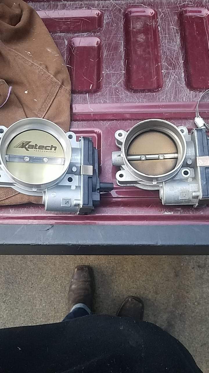

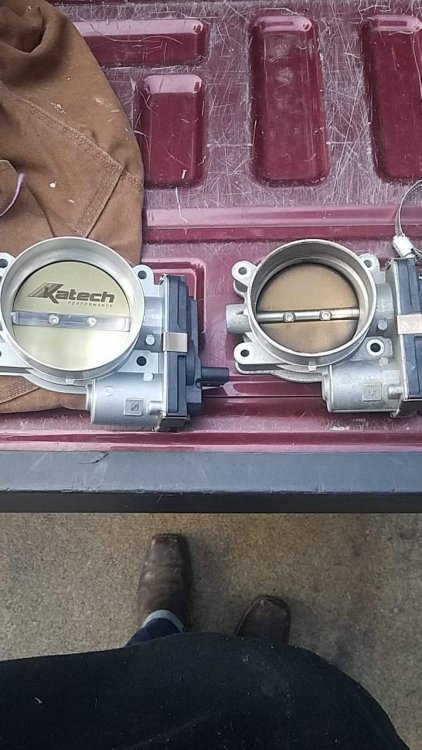

Just swapped my 2014 sierra 5.3 intake and throttle body. Went with the L86 intake and Katech LT1 CNC ported TB. I didn't take any pics of the intake manifold but there is clearly a difference. Here is the difference in TB size. Still need to have Blackbear retune.
