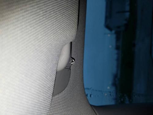

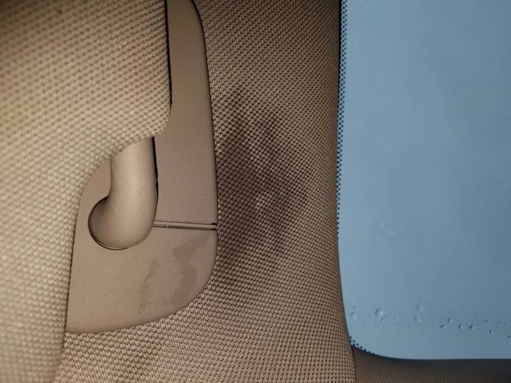

Has anyone had to deal with this issue yet with their 2014 truck? Logic tells me that it's got to be the XM antenna not sealed off right and water leaks in just above the driver side sun visor. Please let me know if you've experienced this and what you did to remedy the problem. Thanks in advance.

I had water dripping from the dash onto the floor on the left side of the driver's floorboard. Because I have 49,000 miles on my truck, my dealer wouldn't look at it under warranty. I was forced to diagnose the leak myself. I found my XM antenna was the source of the leak. The water ran down the antenna's wire, across the headliner, down the inside of the A-pillar trim, through the dashboard, onto the parking brake pedal, then to the floor (or my leg). When I took it apart, I could tell it had been leaking for awhile. There is a metal 3 prong clamp that bolts to the underside of the roof to hold the antenna down. That clip was rusty. I also found the airbag behind the A-pillar trim was wet. Seems like a safety hazard to me. I'm concerned about future problems with any electrical components that got wet in the A-pillar and dashboard.
I paid just under $72.00 for a new antenna, installed it, and tested for leaks with a hose. Dry for now. Hopefully I get more than 3 years out of this one. It didn't appear any different than the old one.
