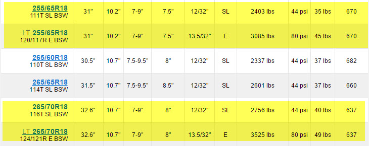

I would choose the LTX, hands down. Interesting note: of the 71 variations of the LTX, 46 are P-spec [passenger vehicle] and 25 are LT [light truck]. Since you drive one of the biggest and heaviest vehicles on the road, I would choose an LT tire as they are designed with a higher load range.
Check out the difference in max load, max PSI and tire weight for the same sizes in the attached chart. They can be 10lbs heavier per tire - that says a lot!
I'll likely be getting LTX M/S [LT variant] to replace my stock Continentals. I'm running BGF K02s [also an LT tire] for the winter duty which are 15lbs heavier per tire than the Continentals, but are in a different class IMHO.
