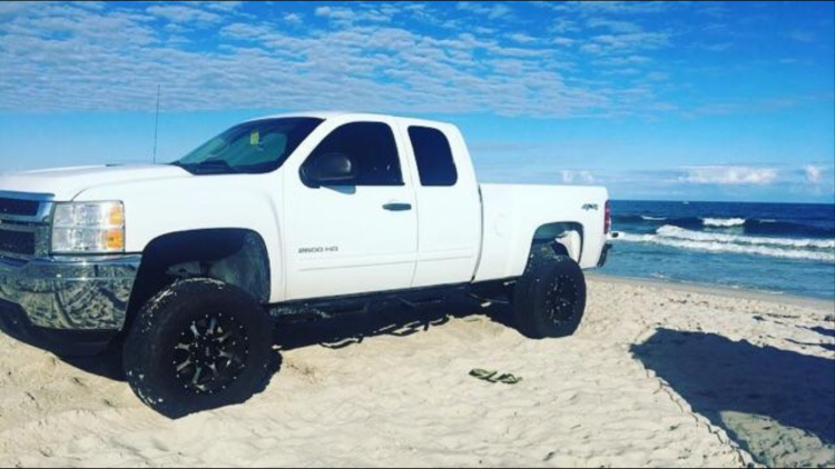

Hello, I am new to this forum. I recently traded in my 2008 f150 lariat for a 2011 Silverado LT 2500hd 4x4. My truck has an 8 inch lift on 37s. When I got it. There was no steering stabilizer installed. I purchased and installed a steering stabilizer. My issue is a shake in the steering around 35-40mph. It does it when on the brakes and the entire truck shakes. Just like the death wobble. The stabilizer helped tone it down a bit. I crawled under the truck and noticed the bushing in the center link where the pitman arm goes through it, seems to have a bit of play in it. I believe this center link with the bushing is called an isolated center link? Is it possible to replace the center link with a non isolated version and get rid of the bushing? Or can the bushing itself be replaced? I love the truck. Shake is my only issue. 25a232512c17feb33ca3b6f24ddf5dd5.jpg
Picture is from when the truck had 38x15.50 on it. Took them off a week after I got it and installed 37x12.50 terra grappler g2.
