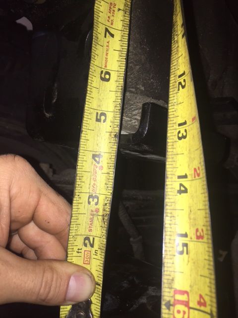

I had a chance to call and talk with tech at Air Lift. The bags I have are not the ultimate's just the standard 5000's. I explained to them that I had lowered the back of the truck 1" ish using drop shackles and told them the problem I was having. They had me remove the bags from the brackets and mount just the brackets to the frame and axle then had me measure mounting surface to mounting surface of where the bags would sit. I did just that and ended up with a measurement of 4 1/4". I would be curious what this measurement is with stock shackles.

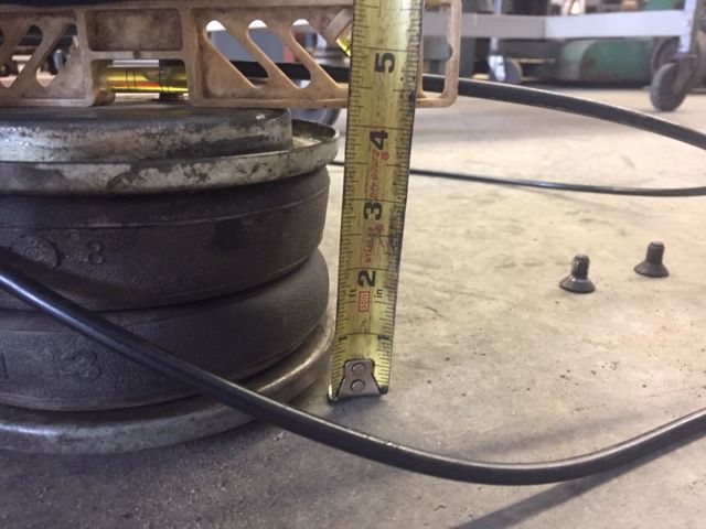

I then measured the bags at what I would say is fully compressed with the roll plates in place and got 4 1/4".
I'm going to assume I had a little bit of air left in them when I first installed them that's why it sat up a inch higher.

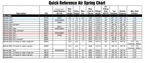

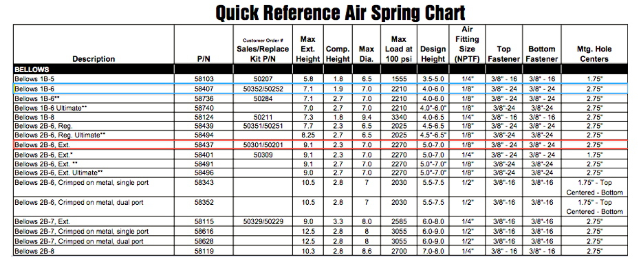

So, Air Lift wasn't a lot help.
Here is there response:
"It would really be your call on what air spring to purchase. I would have no clue what would be an exact fit for your application. You can use our reference chart that I have attached with this email to pick which one would work best for your application."
Below is the chart, I have highlighted in red the bags that are for our trucks in stock form (58437) and highlighted in yellow, are the bags that MIGHT work best for us who have done the drop shackles (58407). Like mentioned above, we need to choose a bag that is spec ("design height") to work within the distance we have between the air bag mounting brackets. In my case that measurement is 4 1/4" (see pic in previous post). Air bag # 58407 (highlighted in yellow) is a single bellow bag, it's max ext. height is 7.1" and uses the same bolt pattern, fasteners and air fittings as 58437. Air bag # 58437 (highlighted in red) is a dual bellow bag and it's max ext. height is 9.1". We will lose 2"'s in max height, is that going to be problem? What happens when these trucks are put on lifts for maintenance, will the axle droop put to much strain on the bags? Will general driving cause the bags to be over extended in some situations? Just some stuff to think about..
They did mention that at least 5 psi has to run in the bags at all times and that will cause a little stiffer ride.
Rear shock length is what will determine how far the suspension will drop when its lifted off the ground. I'd measure how much space you have at full droop and use that to help pick a bag. I'm low enough on my 1500 that I'll have to run outboard bags with modified brackets.
