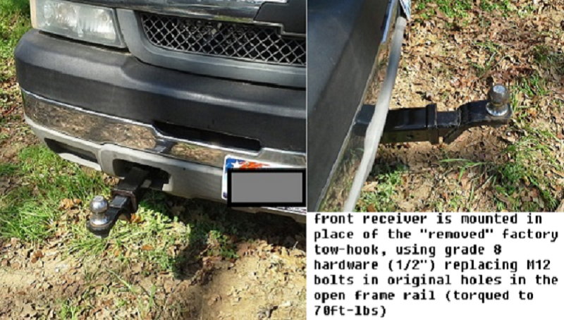

front hitch substitute; fits in front frame rail (tow hook removed &#3
About three years ago, I made a weird front trailer pushbar (as an experiment, a welding practice piece, and a back-saving device), I never did get around to buying a factory - made front receiver hitch. I haven't used the trailer much since, nor had to move it a lot, either, but it still saved my bad back (though the contraption was time-consuming to attach, and by itself, was very heavy). Well, I'm older and my back and knees are worse; I'd never be able to move the trailer alone, so I still need to use the contraption - or replace it. So, I recently went to Northern Tool, with coupons in hand. I bought a replacement wheel, for my spare tire, a yard wagon for my wife (she has two, now), some flashlights. and a 2" x 18" receiver tube. I used a "$20 off $100 purchase" coupon, so I only spent $10 bucks (or so I told the wife) on it. I removed one of the truck's factory tow-hooks from the frame rail, cut part of the receiver tube away (to fit over and around a round frame tube intersecting the longitudinal frame rail), and drilled three corresponding holes in the tube to match those of the tow-hook. Using grade 8 hardware, I used the three holes to bolt it in. It comes straight out of the original bumper space of the tow-hook, so I could replace it if I wanted to. Now, no heavy lifting , and I will always have it available wherever I may be (possible for other uses. Looks a lot better too!
  • post-12584-0-15695500-1489551796_thumb.png new hitch
  • post-12584-0-77786800-1489551677_thumb.png what I used
  • post-12584-0-39846500-1489551654_thumb.jpg old contraption
