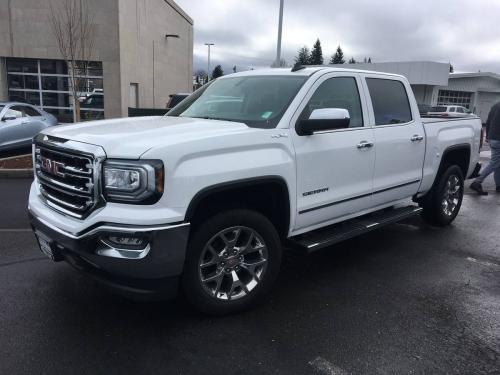

Hello everyone!
This thread will serve as my personal build & service log and allow others to follow along.
I just got myself a dream of a truck, a 2017 Summit White Sierra 1500 5.3L SLT CC SB 4x4! This is my first GMC and my first brand new vehicle I have ever owned.
Package options: SLT CC Premium Package, Power Sunroof, Full Feature Front Bucket Seats/Center Console, Intellilink 8" Touch Premium Audio w/ Nav, Trailer Brake Controller, and an optional 3.42 gear ratio.
While it is still very new, I already have some modifications planned out!
Tint, Air Intake, Cat-Back Exhaust, 2.5" level, 33" Toyo MT rubber, Console Vault, some customized LED lighting, and a DiabLew custom tune are all on the list.
As always, I'm sure the future holds some more.

Late last week I got the tint put on, I think it came out fantastic!
Ended up going with Suntek 70 on windshield as the installer recommended because it had 10% better TSER and was only a hint darker.
Suntek 50 went on the rear three and sunroof, and Suntek 20 on the front two sides. I went with this because the lighter 30 and 40 seemed more blue hued rather than black and I wanted to match the overall shade of the rear three.
I believe I got damn close, and from the inside its still very easy to see out and you have to look hard to notice a difference between front and back.
Also this week the 275/60/20 BFG KO2's and 2.5" Rough Country Lift/Level kit get installed.
Coming along nicely!
Got the 275/60/20 BFG KO2's installed on my OEM 20" Polished wheels today.
Before:
After:
I think it looks fantastic with stock suspension setup.
Hoping it looks as great after the Rough Country 2.5" level/lift tomorrow!
Decided to keep the suspension as is.
I just love the current look too much and also while I have been considering a Bakflip MX4 bed cover I read about water leaks due to the leveling of the truck preventing the drainage channels from working properly.
I'm going to allocate the funds I had earmarked for level kit and installation towards the MX4.
Here's another shot of the 275/60/20 BFG KO2's on OEM 20" Polished rims w/ stock suspension.
