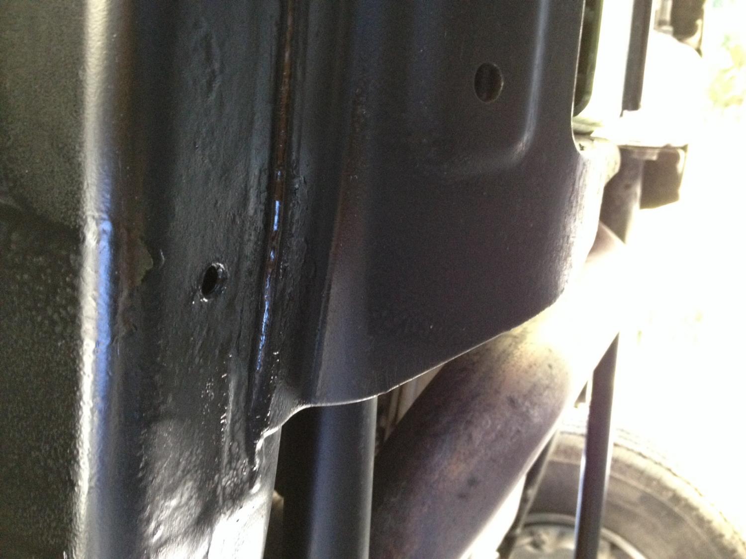

Pic one is the hole I stuck my finger in below the driver door. This hole is about 16" away from the lowest point of my frame and it was full of water.

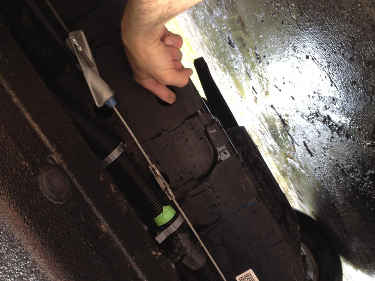

Pic two is the drain hole I drilled. Works flawlessly. It's at the lowest point in the frame under the drivers door. No more water pooling.
