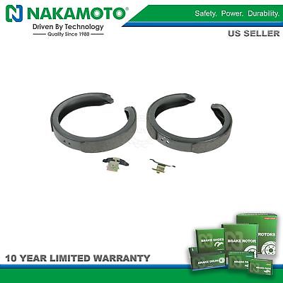

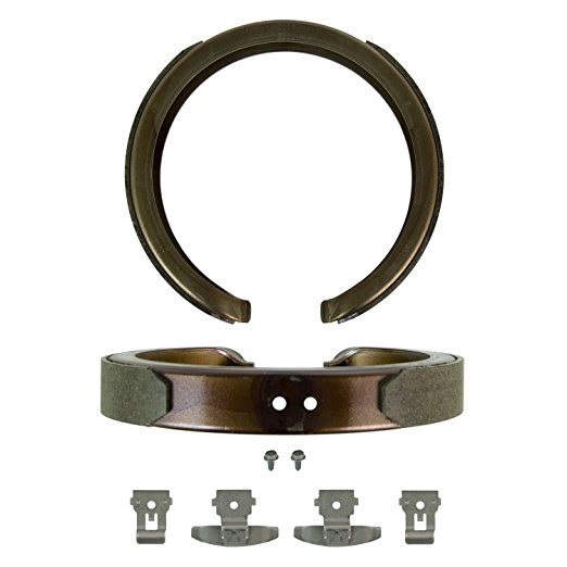

The rear parking brake shoes don't appear to be worn out, but I'm constantly fighting with them. They never hold the vehicle very well at all on a hill, and it puts strain on the parking gear in the trans. I have tried adjusting them as tight as I can without them rubbing, but after a few days, they are not working very well. I tried putting thread-locker on the adjusters to prevent them from backing them selves off. That helped alot, but they still are not very good. I want to replace the adjusters, shoes and all the associated hardware except the rotors. Im seeing two different types of shoes available for this rig. Some shoes have two clips and some shoes have one clip. Something about the GVW? The shoes are not interchangeable. What type of shoes do I buy? The one clip or two? How do I find out using the VIN#? Any info on this would be greatly appreciated. Thanks.

Can't comment on clip qty., but your auto parts store should give you the correct ones.
If in doubt, take home both, return the incorrect ones.
Don't waste money on expensive / premium shoes.

RPO code label in the glove box will tell you what GVW brake package your truck was built with.
