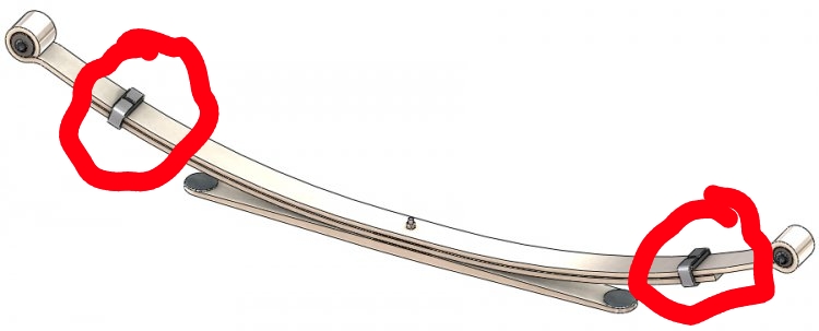

Faint thumping at low speeds , mostly in reverse ? Any thoughts ?

Pressure wash the leaf springs to get any dirt off of them. After they're dry, spray SuperLube on the spots I circled. If it still makes a noise, it's probably not the leaf springs but could be a slip yoke noise.
