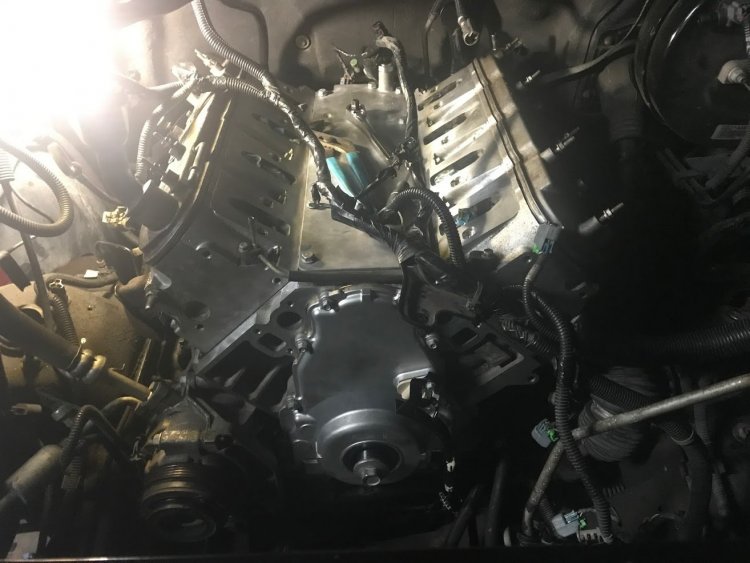

On 11/10/2017 at 8:53 AM, N3tT3chMan said:
Just got cam out. Found my cam bearings are screwed. The engine has to come out. The DOD cam is garbage.

So what did you end up doing?
Pulled engine and rebuilt it. All new bearings, rings, valves, valve seals, valve springs, Stage 2 BTR cam, Non DOD lifters, Non DOD valley cover, oil pump, chain and tensioner, all gaskets, cam thrust plate, tuned

Looks great, how does she run now?  How's the mileage with that camshaft?
