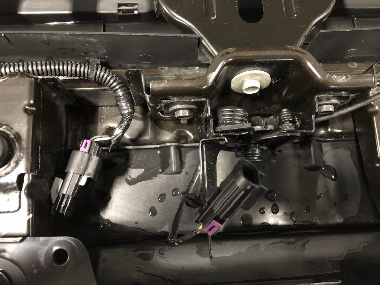

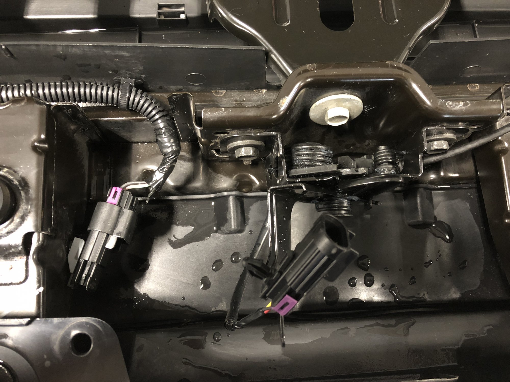

I installed the remote start next.  This was surprisingly easy.  Kit comes with hood latch, wire harness, two key fobs, and activation code.  I replaced the old hood latch with the new (remove large plastic cover, remove latch with two bolts, replace with new latch).  Next I was looking at how I would run the harness when I noticed a female plug lying right next to the latch (see picture).  The plug off the new latch mated right up with it.  How could I be so lucky after reading on here from others on how to run the new harness?  It was all there already installed!  I replaced the plastic cover and was done.
