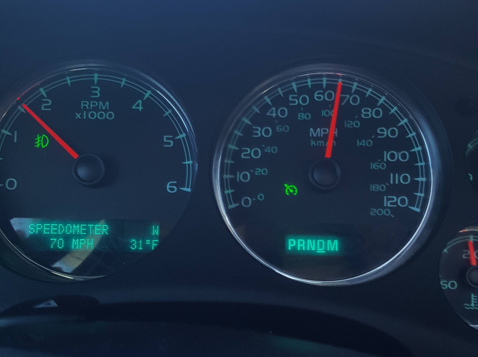

So, I have a 2012 GMC Sierra Denali with a 6.2L. The truck has 132,000 miles and is from Canada. My issue is that the speedometer needle is 5 MPH faster than it shows, as you can see from the digital option. And this speed was verified via my Garmin GPS.  Every thing is factory: rims, tires, etc. Just looking to see what everyone's thoughts might be. I do access to an OTC Envolve if anyone thinks it can be changed with that.

So I removed the cluster and found out it had been worked on before. I took some advise from a local instrument repair shop in town and using a "fork", I adjusted the needle and problem solved.
Yeah probably not adjusted right when they put in the American background when it was brought over to the USA.  A Canadian cluster would have had the 100 at the top instead of 60.
