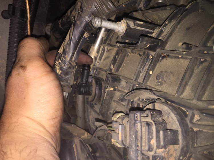

What is the name of the part titled “500” in this picture. Was changing Valve cover gaskets and managed to break it off. Need help with a name so I can find a replacement part.0875486C-7CCC-4A46-BF86-7BA612D388C1.thumb.jpeg.f3687c653f31364cdcaef12bdbd731f7.jpeg
If im not mistaken I believe is integral to the intake manifold assembly.
New intake plenum *OR* similar barbed nipple and epoxy.
Clean the area real well and if possible, attach hose first.
DO NOT DROP ANYTHING IN THE PLENUM.
