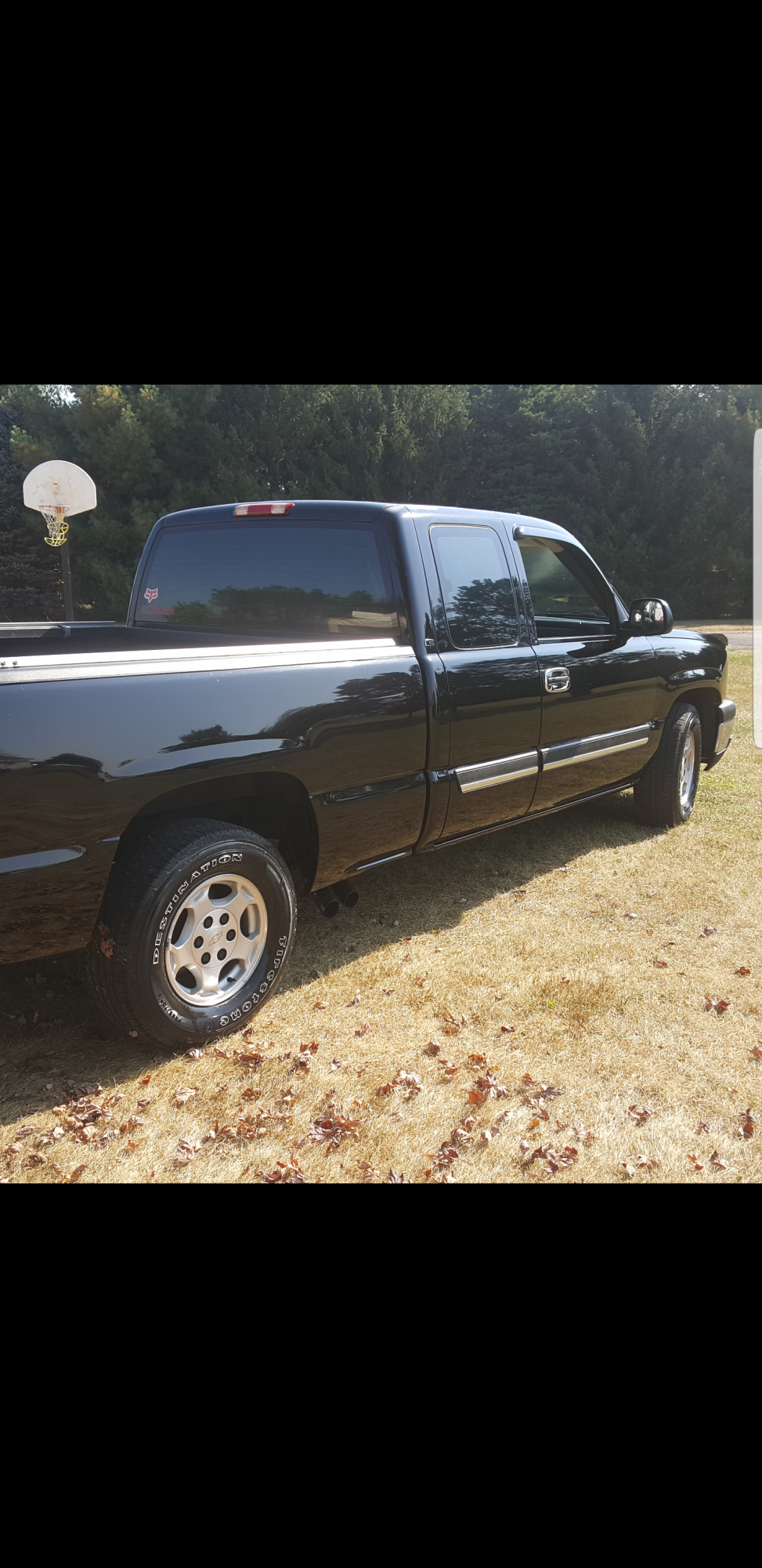

Hey everyone, have a 2wd 03 silverado 1500 LS. Want to get the front leveled with the rear but alot of the leveling kits range from 1" to 3". I dont want to get new tires as im only going to keep it for 1-2 more years. Anyone know how many inches the front needs to go up? Also what is the differnece in the torsion bar keys and the coil spacers? I was just going to get the coil spacers because it seems easier. Thanks!

I wanted to keep the stock tires and just level the front with the back. Nothing too big but if i will need some bigger tires than i will just forget it.
I was only planning keeping it for 1-2 more years since it has high milege then i will trick out my next truck (this is the one i was learning a bunch off of for example using a DA and getting scratches out of black paint)
If i do get the lift, i will do the shocks for sure but cant really afford the knuckle. I will only need shocks for the front then? Is it still worth it if i dont do the knuckle? Ive seen many videos and nobody has changed their knuckles.
I will measure the truck tomorrow (from ground to bottom fender front and back i think is the correct way) just so i know what size lift to get if i do decide to get one.
Thanks a ton for the help!!
Also, I measured the distance from the ground to top of fender and here are the measurements:
Front Left: 32in    Front Right:33in
Rear Left: 35in     Rear Right: 36in
Is a 2 inch lift kit going to be enough? Thanks again
