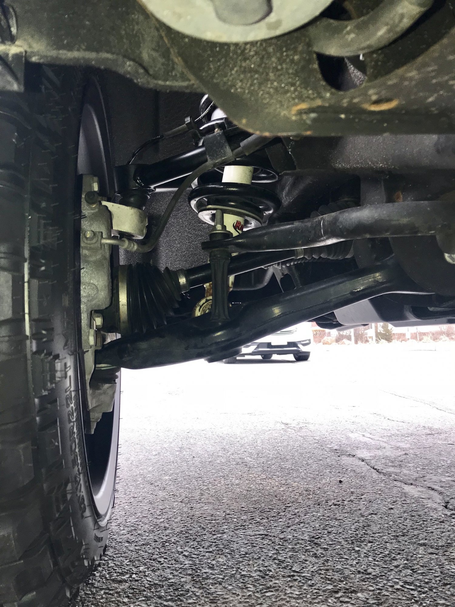

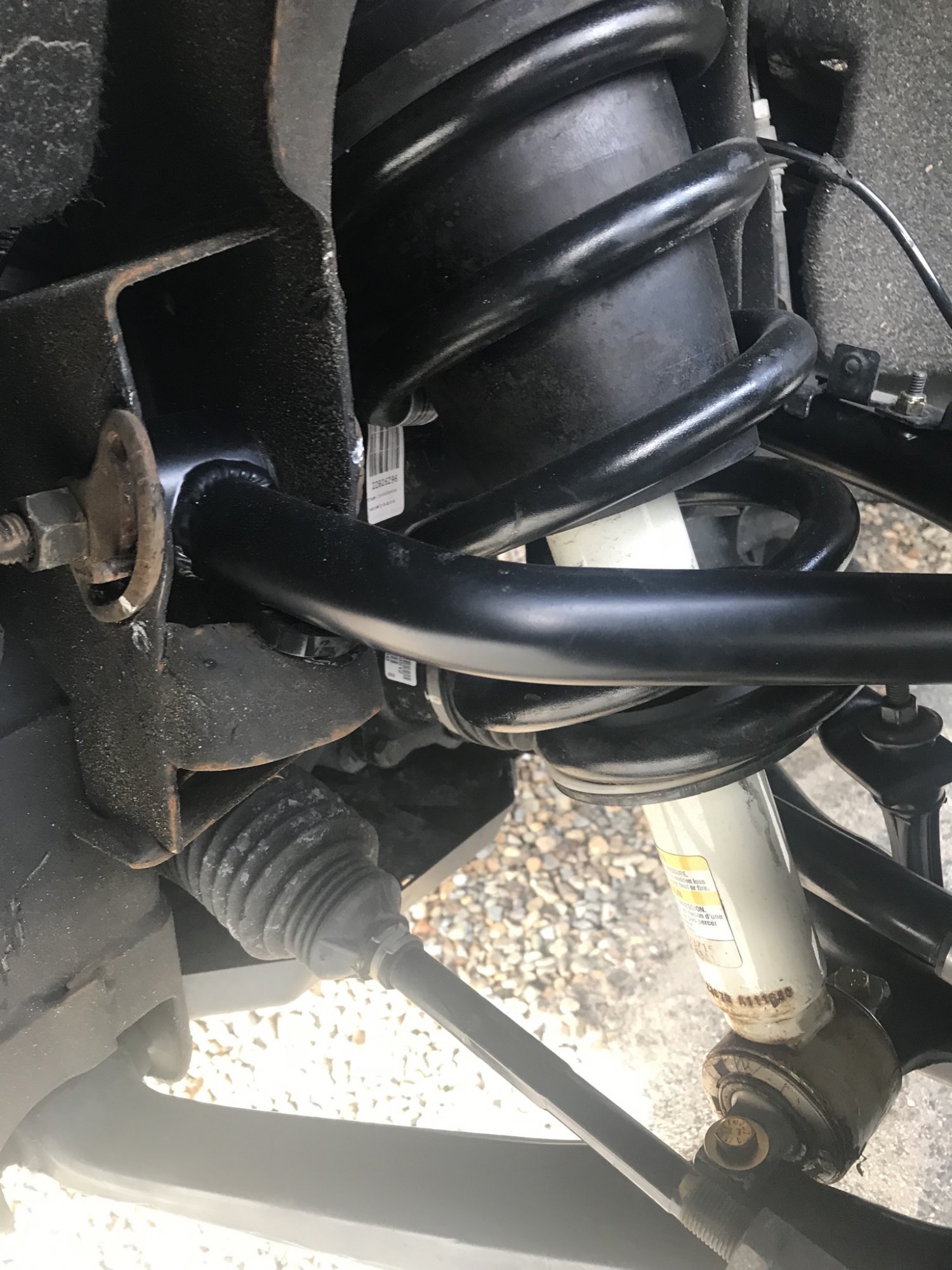

Hey guys just installed a motofab 3” front level with new Readylift UCAs on my 16 Silverado. I know that people don’t like a level that large but I really love the look of my truck now. The ride is firm but no problems and no loud noises or clunks.
The only issue I have is that the new larger tube UCA along with a level this size has the arm essentially resting on the rubber of droop stop. I’m considering just cutting them out as I don’t do any off-roading. Anyway here are some pics. Any suggestions?

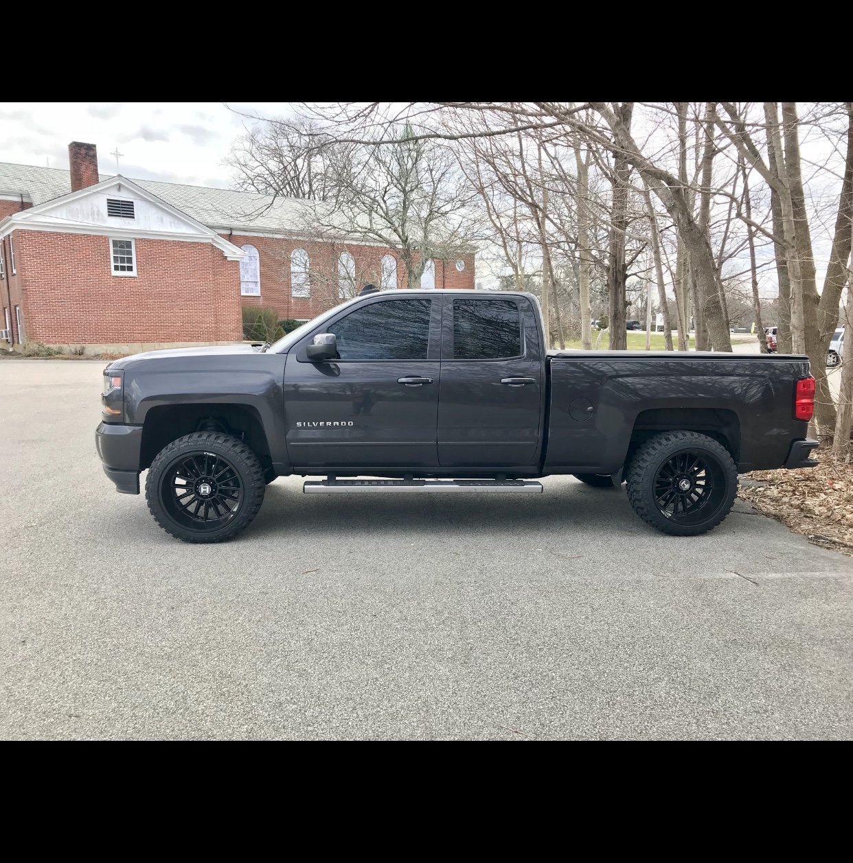

Side profile?

Looks good what's spec on wheel and tires? Any rubbing?

22x12 -44 offset with 33x12.5, with just a few taps of a mini sledge in the cab side inner fender well corner area and surprisingly no rubbing at all. No norcal mod.
Front fender is just a hair under 42” and the rear 41”
Ok thanks for the info 3" front and 2" rear block?

No that’s stock rear I only touched the front end. These trucks have way too much rake stock and I don’t tow anything. I think the very slight nose high makes the truck look awesome
Not too sure why you sacrifice reliability for looks. If you don't have any down travel left that means you are past engineered specs. Pay now or pay later.
